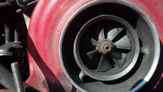

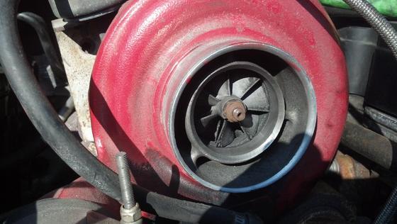

While taking my turbo's out, I saw this on the PS62. Is this oil coking? There is some up and down shaft play. Just enough to see it moving. Pretty sure I will need a rebuild kit for a PS62. Are they a base s300? I can find lots of rebuild kits for them as well Is my CHRA shot on this turbo? Where can I get a chra if I need one? The K31 looks pretty similar the PS but there is no shaft play at all.

Oil Coking is on the bearing, not the compressor blades.

Yes it is an oiled filter. It was really disgusting. Instead of trying to clean it I tossed it and bought another one. They come pre-oiled.
I can look into it. I pretty much thought all the cone type afe,airaid etc... are all oiled filters? What do you reccomend that would fit my setup?
There are more and more dry filters available. Donaldson and Amsoil have a bunch that cross to many of the oiled filters.
Wow, that's ugly, wonder what the charge air cooler looks like? Could be why egt's are getting out of hand. Just my opinion, but that looks like more debris than an oiled filter would cause, more like a breach in the intake.

Didn't really find any dust, dirt, oil in any of the charge air tubes. Could be an intake breach though. I did find some rust on the outside of my charge air pipe though, and I noticed too that the o-ring on one side is flatter than the rest of the ring. Don't know if it was not quite sitting right Good time just to go through everything

Was this the first look after 100k miles? Not dissing, just trying to figure if this happened over time or recently? Doesn't take much of a leak to allow unwanted debris. I had a dry Amsoil with a slight tear that left just a slight film of dust in the intake tube, only used it while servicing my AFE so I lucked out.

No I have taken a look on more than a few times. This time was a little longer than usual. I did notice some fraying in the netting of the filter from rubbing the inner fender wall Could be from that. or somethng else. So sfound I jsut go with a rebuild kit for the ps62 or try to find a chra?

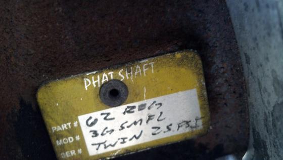

I get where you are coming from Axe. I called/emailed some other turbo repair shops to not get a response, or one place actually asked me to email him, so I did but did not receive a response. I actually did a search and came across a post of yours! I looked up some places an the web and decided to call XS boost. Dave actually answered, I told him I was looking to rebuild my PS62. Asked basically what it entailed and what upgrades he could do to it to make it better. They got my turbo just today, I am hoping to hear something from them tomorrow on what they found. I know my turbine housing was cracked in 4 spots and there was some up and down movement in the impellor shaft. So It definitely needed some love. Its going to go over a new S475, so I will need everything I can get to help get the s475 spooling quick.
Was going to get an HE351cw turbo remade from XS boost. But Source Automotive said that their turbo piping kit with the S475 that I have would cause the drive pressures to be too high. So I am going to do with a rebuild of my PS 62 which is a base S353 turbo. They are going to upgrade the turbo to an S363with a billet wheel. I also just realized that aparaently I have an HX40 (4 inch) exhaust on this turbo. What I need is an HE351 (4. 4 inch) to mate with my new downpipe. So I will need a new exhaust housing for this turbo to work.
