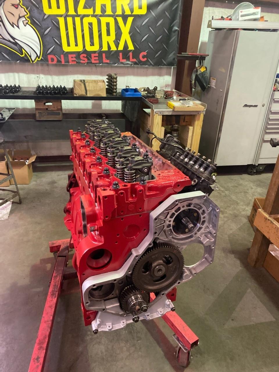

Looking for a single turbo for my 98 12V my Son owns now. He had the engine rebuilt by Wizzard Works in Kemp, TX. The owner got about 60 miles on it and noticed low coolant. He had used ARP studs on the head. He is running 18 degrees with custom Piers fuel plate and 4k springs. Trans is a DTT single disk 91%.

Ummm...there are other issues if the drive pressure from the stock turbo caused a HG issue, and I’m not aware of any single turbo that can be street driven that needs an o-ringed head. Sounds like an excuse to me.
I wouldn’t o-ring it, that’s not a mod that is daily driver friendly.
O-ringed heads don’t like like the duty cycle of daily driven motors, meaning more frequently going they heat-cool-heat, etc. They are not as reliable. Their intent is to create a better seal on a more short term basis.. but the need isn’t there in this case.
There is no good reason to have an o-ringed head on a single turbo truck, or even most twin turbo trucks.
Nothing you have said about the motor, mods, or use points towards an o-ringed head. If the builder is blaming the use of coolant on the stock turbo he is just looking for a way to get your son to pay for his issue, IMO.
What John said. I thought the same thing reading your original post. With the mods you have listed, he doesn’t even need studs, much less o-rings. Your builder screwed up.

My Son said he spoke to "someone" and they said the O-ringing was not an issue but Fire ring may be? Personally I would have thought studs would have been plenty.
Head and block were completely machined. This guy is very meticulous and does a ton of complete rebuilds on the Cummins engines.

Edit, builder did NOT blame turbo. That was my Son's assumption.
He is pulling it apart and making it right. Orings I don't know.

Again, with the mods you listed, if the builder did what you said, something either wasn’t done properly, they made a mistake and messed something up causing the new gasket to fail or, the new gasket just failed. Things happen. I’m sure it wasn’t something they purposefully did. I’ve seen even the best techs make a mistake. They’re called come-backs, basically “warranty”.
You said the builder’s making it right and redoing it. Sounds like a reputable builder.
My Son did a lot of research and in person interviews. One thing that impressed me was he didn't finish the install and say come and get it! Owner/builder had been driving it for about 60 miles and noticed coolant low.

Shop owner doing the work told my Son he also checked the top of the block and it's also perfect. Must have been a bad head gasket.
