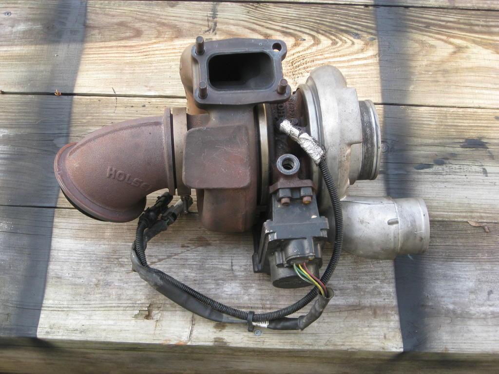

Well it seems that the emissions soot disease is slowly taking out a second turbo charger. 1st turbo changed at 45k miles and now at 79k miles I am getting the P2563 code "Turbocharger boost control position sensor circuit range/performance". I could hear and tell the exhaust brake acting up (sticking) and engine having no power - flat spots etc...
It frustrates me such that I am very particular in how the truck driven, used, minimal idling, mostly highway runs and religious use of the exhaust brake. So it goes.
So with that said I am either going to have the current turbo sent off to be rebuilt or get another reman unit and install this myself. So far all the suppliers tell me that the turbo will be properly calibrated when it arrives and will essentially be a remove and replace operation. Prices seem to be all over the place so I am trying to decipher which one seems to be of quality.
From your experience do you have any tips or tricks for what I am getting into?
Are there other consumable parts I should have on hand such as gaskets, oil lines, etc...... for preventative maintenance?
After the truck is fixed then the I will figure out what to do with this truck. It will either get deleted and run a stock delete tune or get sold and possibly go back to a gas truck. Frustration abounds.......
Normally when you buy a Reman turbo it comes with the necessary mounting hardware, gaskets, washers etc. These turbos have plumbing for oil in and out as well as coolant in and out. Make sure it comes with ALL the mounting parts as well as 2 studs and 4 nuts. Two studs go in the turbo and two in the exhaust manifold, two pointing up and the other two pointing down, that's why you only need two. The two in the manifold can be left alone but the nuts can get wrecked coming off. The last part to go on is the oil feed line so before you fire up the engine for the first time with the new turbo on make sure to pour some fresh engine oil into where the oil feed line goes on to the turbo. This will give it a pre-lube. The turbo drain pipe is a pre-bent flexible part and can also get munched when removing the turbo.
The exhaust clamp between the turbo and the cast elbow is a Cummins part but the one going to the exhaust pipe is a Dodge part. Usually the Reman turbo comes with the cast elbow already attached
I took a little time off of work and completed the replacement today. Had to clear some codes because I forgot to plug in the sensors for the air cleaner and had to finish tightening the water line to engine block connection. The two toughest parts of the job was figuring out the puzzle to get the old turbo out and the new one in. The studs made the job interesting. The other fun part was getting the gasket in place for the oil return line on the bottom of the turbo. I finally got smart and put a dab of form-a-gasket to hold the gasket in place while trying to get the bolts lined up. The rest wasn't too bad as I have been in much deeper on other vehicles/projects before. I have some stubby wrenches and other odd ball stuff that doesn't get used too often which helped out on this job. Tomorrow the core gets shipped back.

Here is a picture of the offender.....
