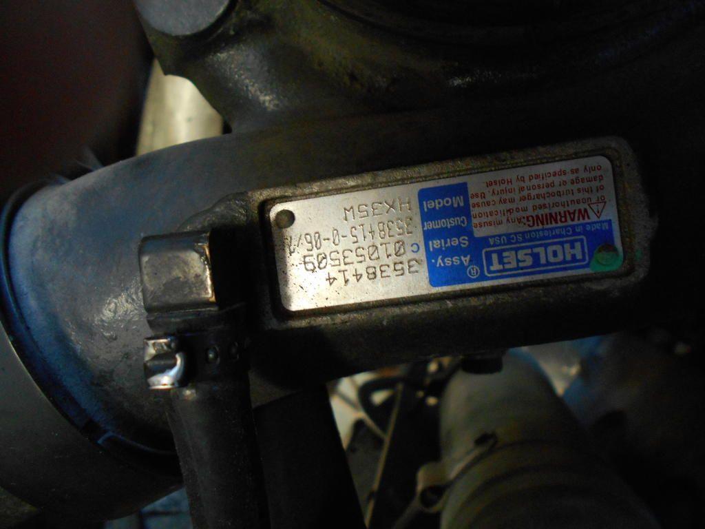

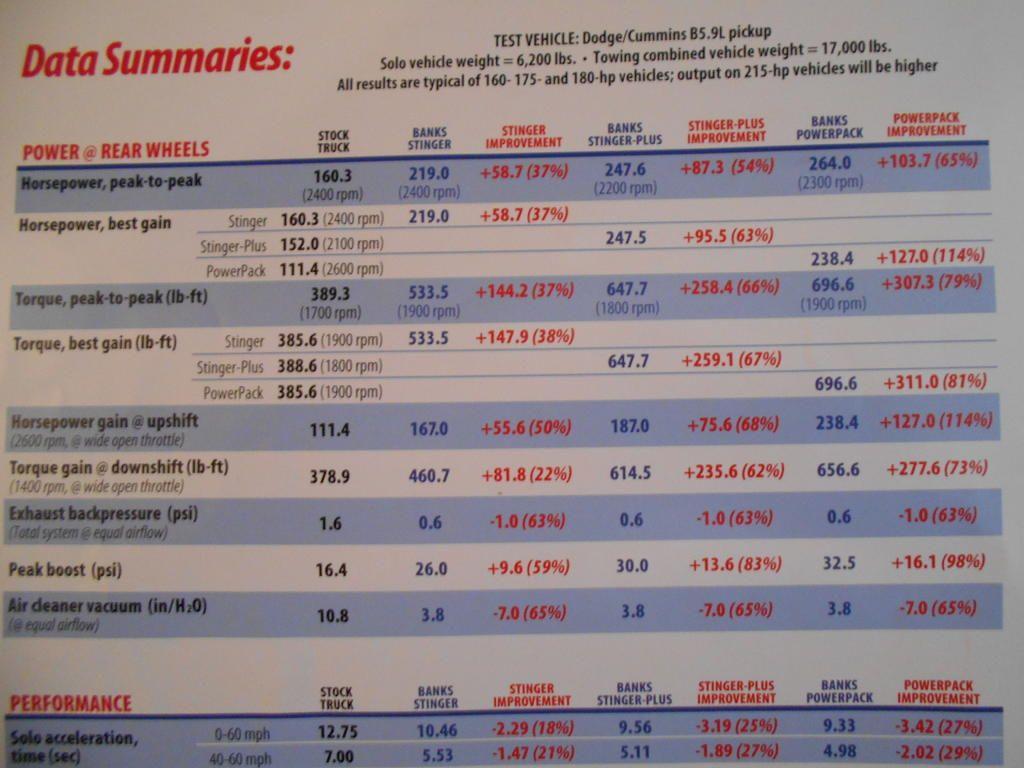

Hey, Bob4x4,all I know is this is the system my Dad put on the truck before he passed.It's the PowerPack System from Banks
Ok so you already have the bigger turbine housing,without adding more fuel your turbo is hard to beat at that power level
