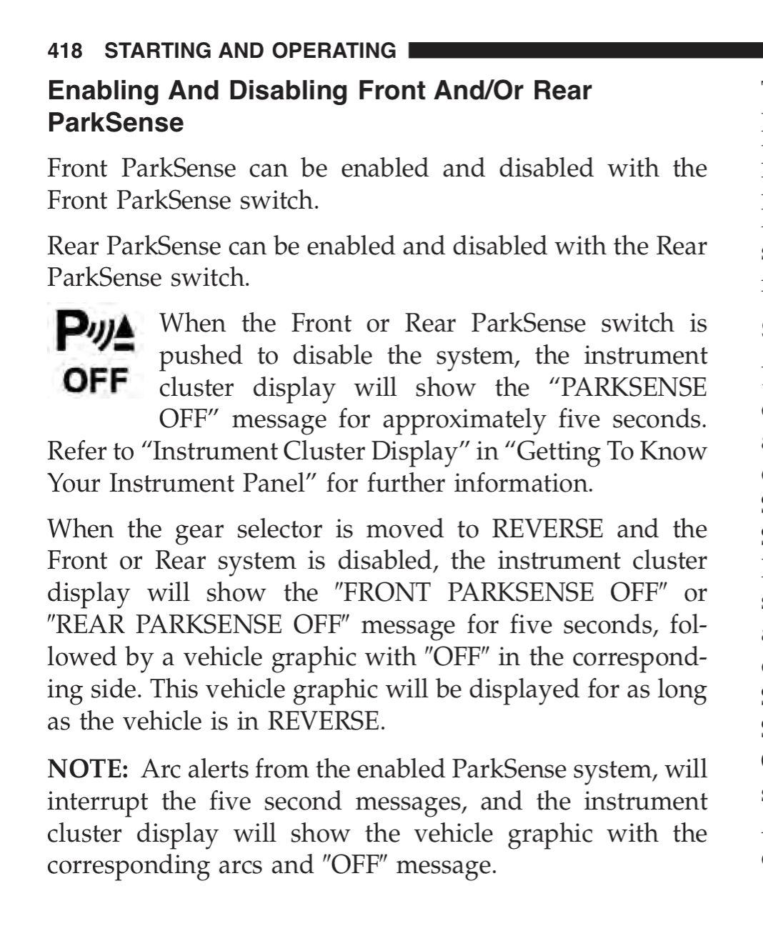

i drive my 18 2500 tradesman back and forth from jobsite to a barn a lot
in reverse with tail gate down
there is a ear splitting tone that comes on when in reverse with tailgate down
i find it beyond irritating, especially as i transfer building material from barn to house...
is there a way to disable this?
im a caveman, so sorry if the answer is right in front of my face. i looked at manual, but didnt run across anything.
thanks in advance
cheers!
Disable button is on the dash. Turn off rear parksense.
