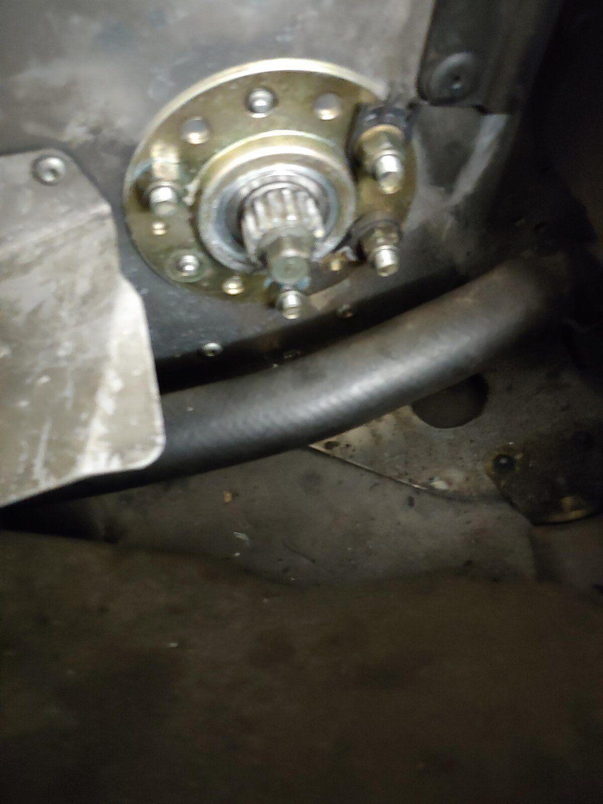

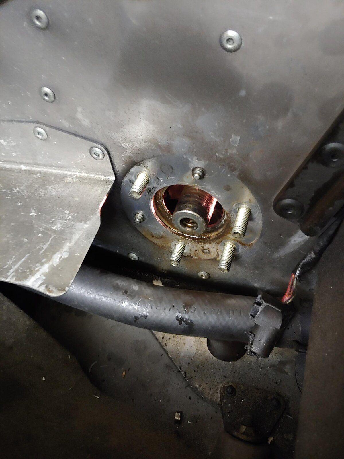

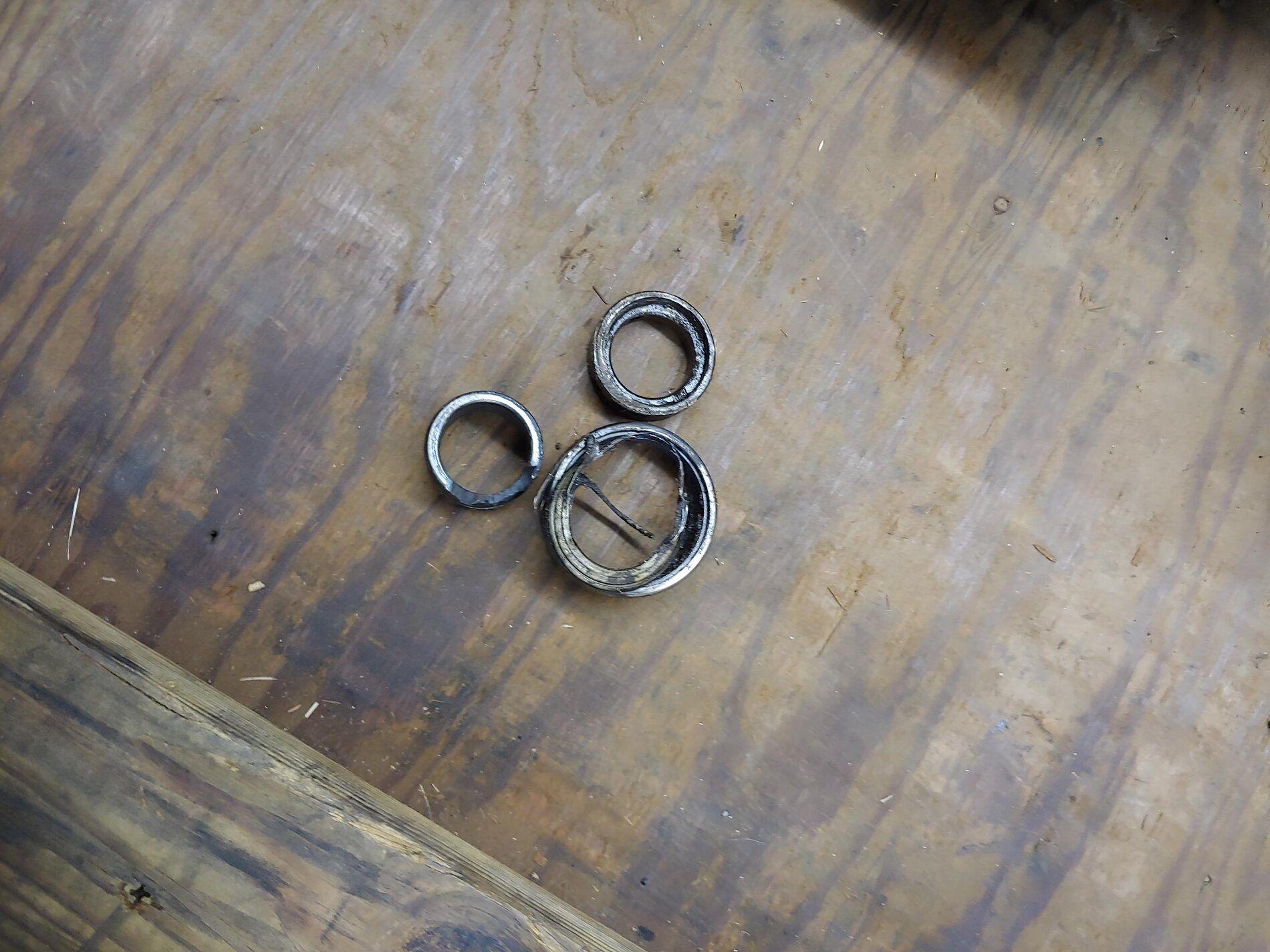

Here's some picture of the drive Bearing on My Apex Snowmobile, You can see the rust and what's left of the bearing, it destroyed the speedo Sensor so the repair add $113.00 and two days lost Riding here at West Yellowstone MT.

Here's some picture of the drive Bearing on My Apex Snowmobile, You can see the rust and what's left of the bearing, it destroyed the speedo Sensor so the repair add $113.00 and two days lost Riding here at West Yellowstone MT.View attachment 111856
That bearing went because those Yamahas weigh a metric ton! I used to have turbo’d nytros and Apex mountains and just made it a standard practice to replace jack shaft and driveshaft bearings every 1500 miles. By 2000 miles one of the 4 was ready to grenade.
Don Yep, that Bearing is aftermarket and went 3300 miles. I've spent over $5K lightening up My Apex. its a beast now... Your right don't get stuck.....still.....
