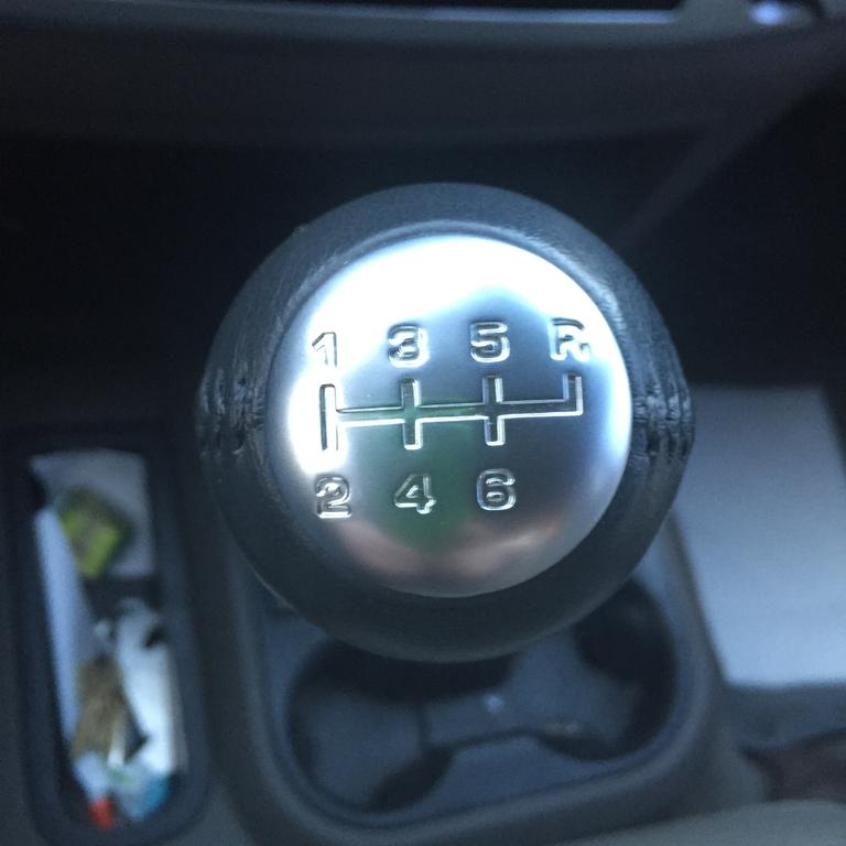

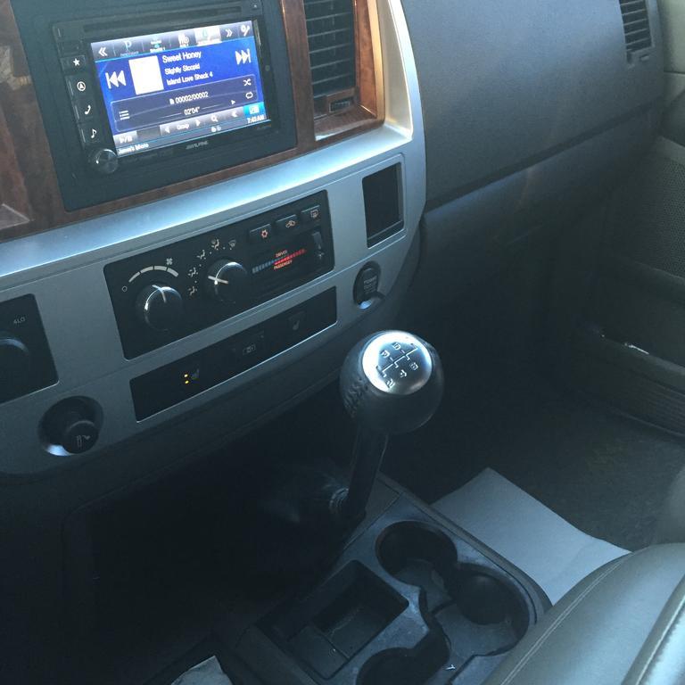

Destroyed the stock knob trying to get it off to repair the shifter boot. With some help with a couple members here we came up with the Ram SRT 10 shift knob part number. The threads had to be chased to fit on the shifter( used a M10x1.5 pitch and hand threaded it with the tap in a vise and turning the ball by hand). It looks and feels a lot better then the POS stock knob(IMO). Even has a anti theft system built in for someone unfamiliar with a G56 shift pattern! $108.00 shipped to my door from a dealer in Ohio who had it on the shelf.

Part number for the knob is 0503743AA in case someone is interested. Dealer wanted a VIN number to look it up for me. Lazy SOB....
Looks nice, but for the price you coulda bought a couple of shift knobs from Geno's.
No shift pattern at all makes it hard for most to figure out, but having the NV5600 pattern clearly stamped on it is gonna make you cringe every time you go for tires and some idiot repeatedly tries to back out of a parking spot or service bay in 5th! Trust me... It WILL happen even after you tell them where reverse is and leave a sticky note on the steering wheel as a reminder #@$%!

I think you left out a "3" in the number. What was your price?
**Chrysler parts direct.com**
[ 1 ] BODY HARDWARE / CONSOLE / SHIFTER TRIM / Knob
Part Number: 5037433AA
knob 6 SPEED MANUAL TRANS (T56), 8.3 LITER
MSRP Core ? Online Price
$113.00 $0.00 $88.14
nope, that's what I paid. someone had ordered it and didn't take it because they didn't like the stitching. they gave me a discount because it was new opened stock.
