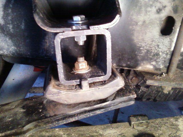

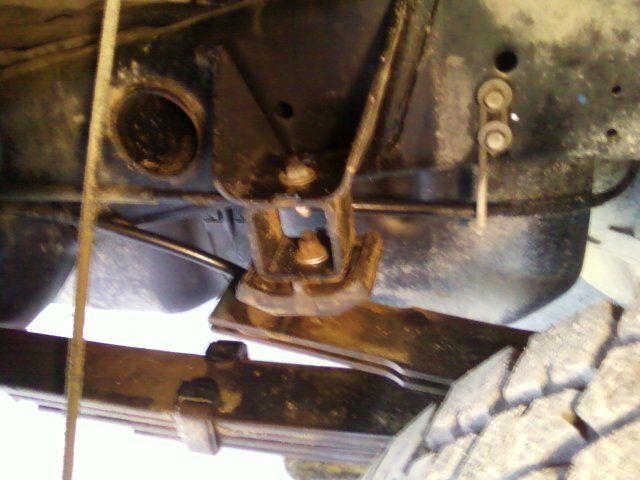

I keep true to the Kiss principle. first step was to install taller bump stops made from 2' TS. this engages the upper springs sooner with less weight required,

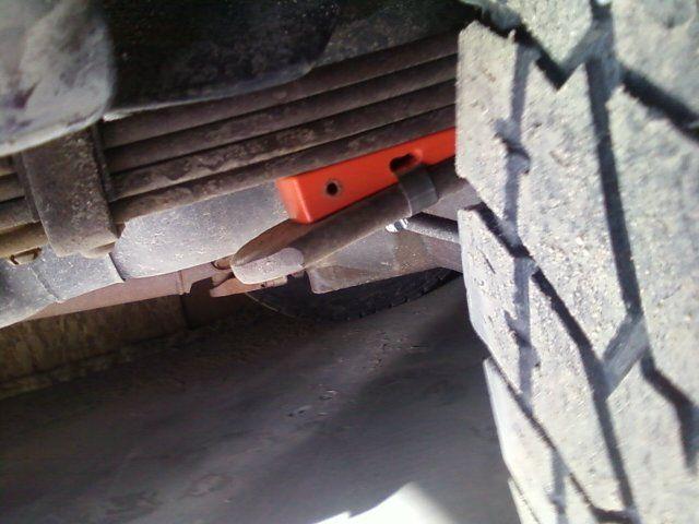

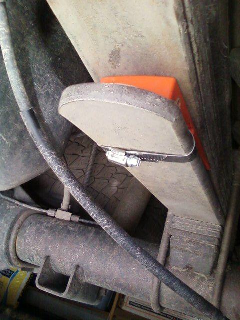

I also installed felling wedges as suggested by a member here, they are in between the thick bottom overload and the bottom of the leaf springs. it take less weigh to engages these lowers sooner. It rides like a truck should.
