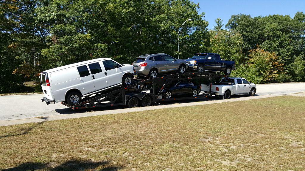

Has anyone upgraded their 3500 rear axle and suspension with that of a 4500 or 5500?
I understand I will have issues if I only try to use the leaf springs out of say, a 5500 because the U-bolts are of a different size. I would also upgrade the rear axle because of the loads I haul.
I regularly haul 4 cars on a 10,000-lb Wally-Mo so I am sometimes grossing 36,000-lbs with a pin weight of 14,000-lbs

Your pin weight is 14k plus the trucks empty rear axle weight of about 4k for a total of about 18k on the rear axle? If so the Dana S-110 is still under rated, I think they are rated 13.5k?
I think the rear axle from a cab chassis is narrower than a dually pickup and use a standard 34" frame width. Take some measurements of both trucks and see what the difference is, it might be more trouble than it is worth.
Nick
Ohhhh, I never thought the frames were different. Then, yes, this would not be a very financially beneficial swap for me.
You do realize a 5500 has a bigger frame to handle the 18k GVW 13.5 gawr and you are over a 5500 rating. You need something bigger than a 5500 for the load you are carrying.
