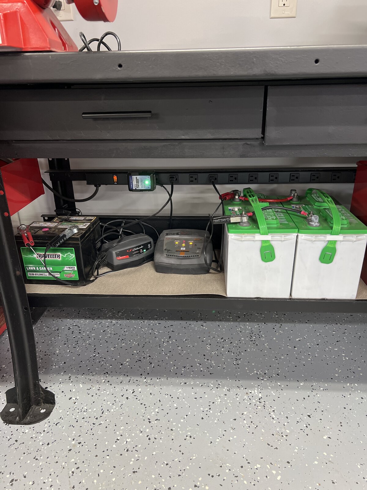

I have a 2A NOCO under the hood of my 3500 and it’s not enough. I have a 10A one that is going to go in its place. I also have a 4 channel 2A one mounted on a shelf in my garage that I maintain 13 batteries through winter with that come out of quads, mowers, tractors, boat and RV’s. I just shuffle the clamps along to the next battery every other week.
I also have a 2A mounted under the hood of my Jeep JL diesel that has two batteries and 2A isn’t enough there either.
Go 10A or you’ll regret it for a dual battery truck.
