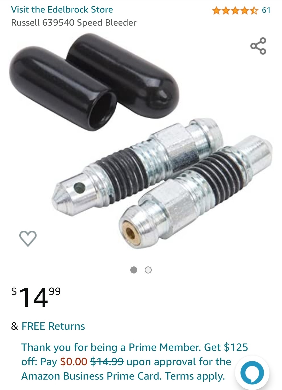

I have not used them but I got these speed bleeders where they are spring loaded deals.
I got them from Amazon, they are also.in Summit and Jegs.
Just Crack and pump and they bleed out and seal on the return.
This is not the exact part number for a Ram just an example of what I got form my other projects.
But the pressure ones are pretty slick and I like what Ozzy said about it refilling the MC what's pretty cool.

Speed bleeders work good but I still like the good ol push brake pedal crack open bleeder close bleeder lift pedal repeat until fluid runs clear and bubble free.
