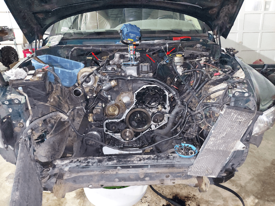

IIRC, it runs under the lip at the top of the firewall; you can trace it from the vacuum pump. When I replaced my A/C evaporator, I pinched the original line when I reinstalled the 'box'. Rather than remove the box again, I just ran a new line in at the convenient spot in the firewall on the driver's side. It's been working fine for more than a few years.
This was my '98. I painted some red arrows to point the vacuum tube out. The yellow tubing in the pic was some vacuum tubing I used to replace a piece.
Off topic question. What were you doing to your truck when you took the picture?
Mainly replacing the front gear housing gasket. It was leaking bad. We also replaced all gaskets except the oil pan and head gaskets and replaced the IP with a used low mileage pump I'd picked up several years ago.

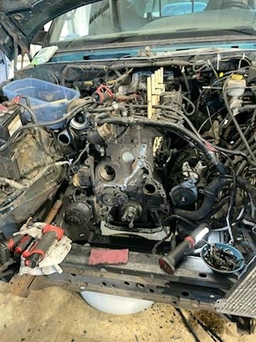

The last time my truck looked remotely like that, I was putting a tab over the Killer Dowel Pin. That was a long time ago. I would have to check the logbook to figure out exactly when. Arthritis hadn't set in yet, so I was able to leave most of the cooling parts attached. If I had to do it now, I think I would remove most of the front like you did.
