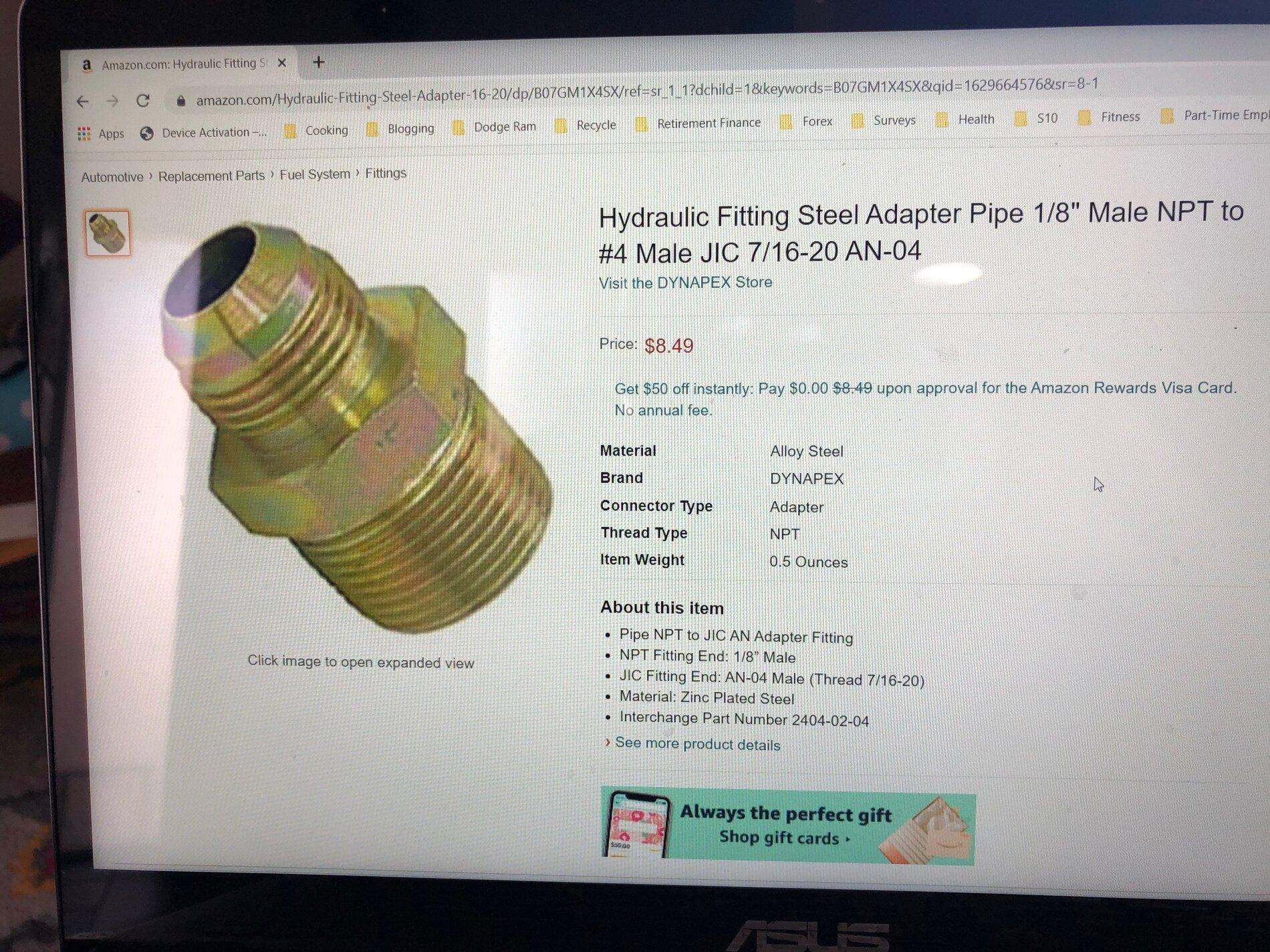

If you’d like to get one from Amazon, ASIN is B07GM1X4SX.
Again, the Edelmann PN 148420 referenced on Cummins Forum is SAE 45*, not JIC. The Cummins fitting in the VP, 68138, is 37* JIC.
JIC fittings typically don’t have sealing issues unless they’ve been severely over torqued or damaged by something bumping or dragging across the sealing surface.
This is the item that comes up on Amazon using ASIN B07GM1X4SX.

Amazon’s image is generic, but the description is correct. It’s 1/8” MP to #4 male JIC. I’ve never used any of those seals. In my opinion, not necessary. If yours is leaking, there’s damage or trash on one of the sealing surfaces.
