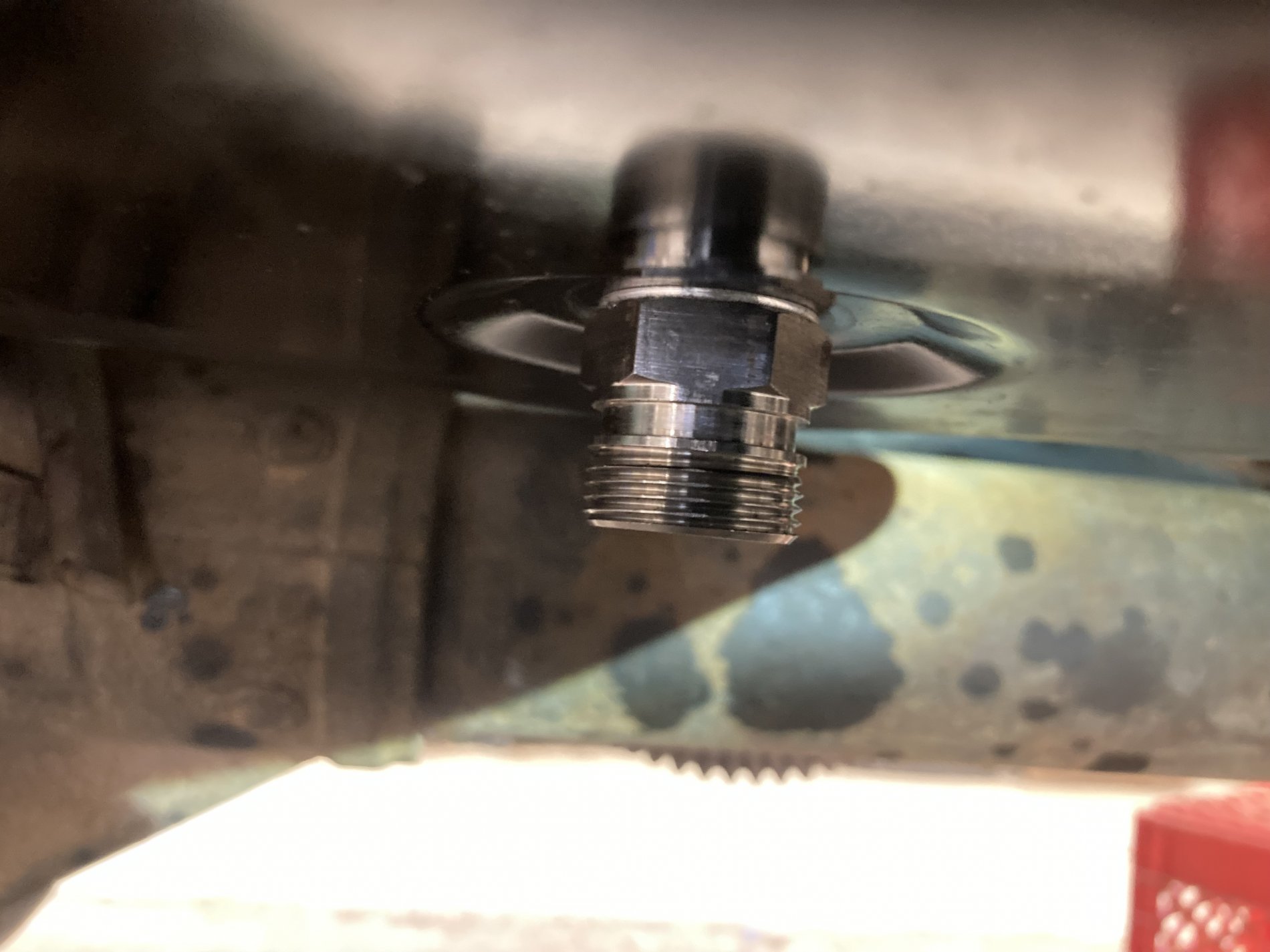

I carefully measured before installing it and confirmed that the nipple does NOT stick up past the inside bottom of the pan, like some other designs do, thus allowing for complete oil drainage, as much as the OEM drain plug.

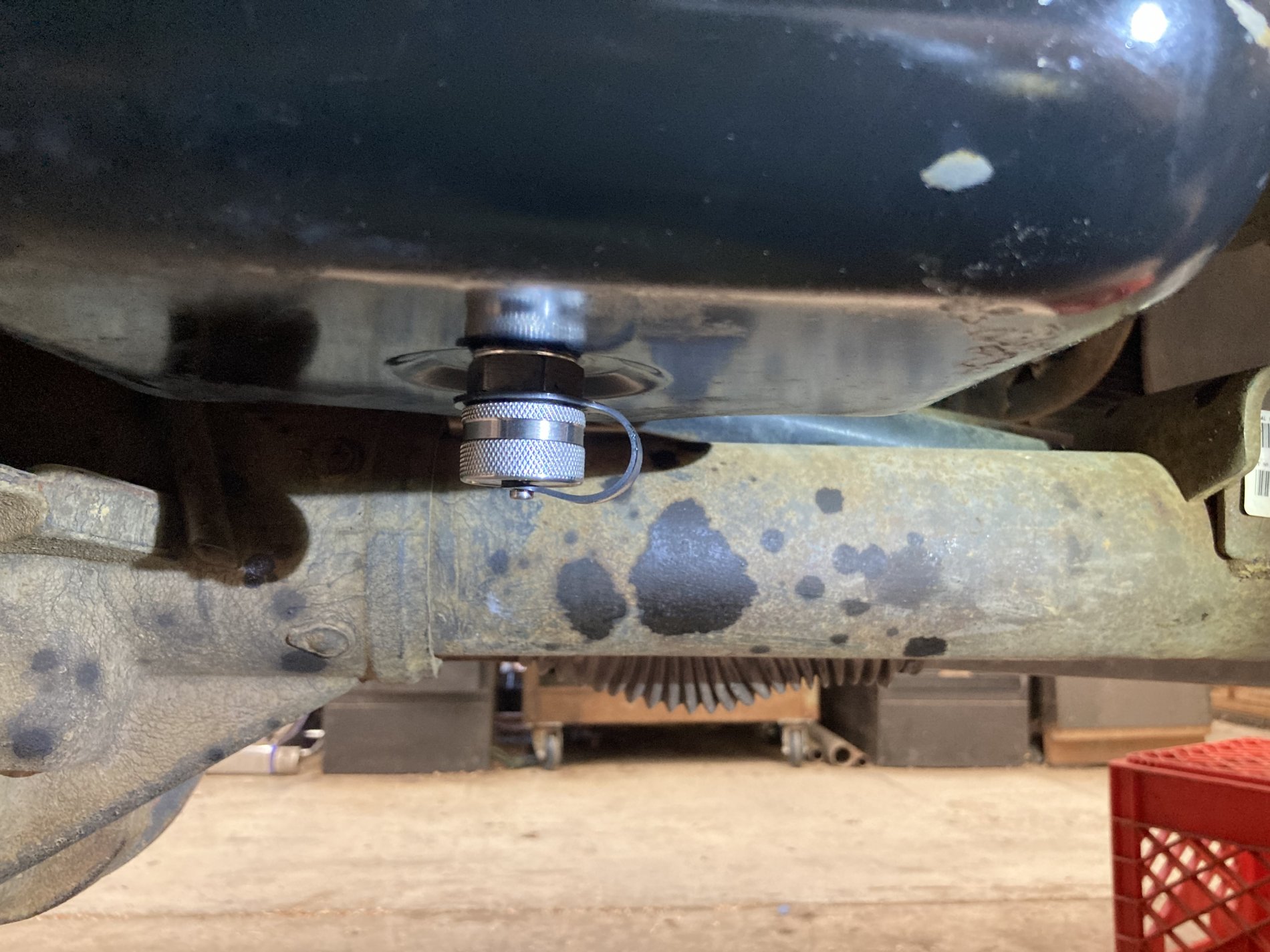

It also does NOT hang far below the pan, staying well above axle height.

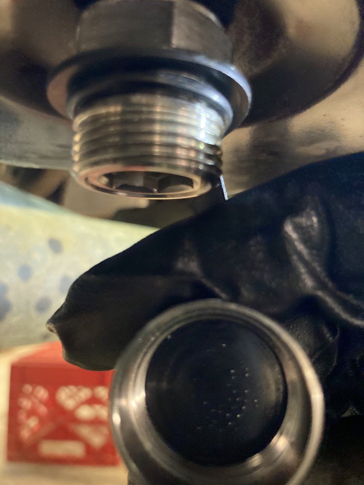

It uses a spring loaded ball bearing "valve" that pushes up as you finish screwing on the hose attachment that comes with it. This design allows for full flow as well as a clean catch …JUST what my Urologist ordered.
It also uses both an O ring and flat washer to seal the cap against the drain plug, so along with the ball bearing seal, it is TRIPLE sealed with the cap on… NOTHING to worry about there.
Obviously, installation was a no brainer…after draining the oil from the Cummins overnight, I simply slipped the cap, cap retainer and cap o-ring from the ValvoMax body, then screwed it into the oil pan with the compression washer that came with it. I torqued it snuggly to the OEM specs of 40 foot pounds with a 24mm deep socket, then slipped on the cap retainer, cap o-ring, and the cap back on it.

While I haven't used it yet, the easy to screw on hose attachment also seems very well made and will definitely prevent the spill and spatter from the 3 gallons of coal black oil that the mighty Cummins can spit out during a hot oil drain.
