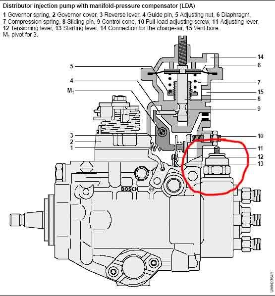

IT,S ALIVE! BUTT?
thanks NIsaacs. my truck is in the shop due to a broken wrist. Was having a hard time telling the mech where the shut-off was on this pump.
