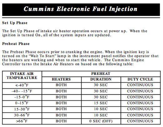

EDIT 1: Thought you might find this interesting...
