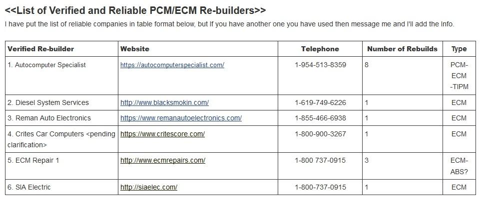

Everything I'm seeing indicates the ECM too. There are some threads where folks sent theirs in for rebuild. If you're one of these, what has been your experience with the vendor and the product? I assume that I cannot get a new one from either Dodge or Cummings. Also, after a rebuild, does it need to be flashed by Dodge?
Mine is still original. There are 2 posta around here with reputable rebuilders. I will look around and see if I can find. No promises. No reflash required and no new ones's available that I have seen.
Here is one from moparman1973.com. There is another one tho.

I used a place at the time called auto computer exchange out of Florida (probably 10 years ago) they appear to still be in business though. Gave them the info, they sent one out it didnt work for me, called them iirc I had to send the first one back then they sent me another one sort of a pita but the second one worked fine and is still going today. At the time there were not too many choices and none of them had great reviews well they all had mixed reviews some great some stank badly so it was sort of a crap shoot I rolled the dice as who I used seem to have the most good reviews at the time but they still had plenty of bad ones. Worked out ok in the end, at least for me.
They needed to know year, make, model, auto or standard trans and whether fed or CA emissions, vin I think and perhaps mileage cant remember that for sure (but after the swap the mileage was correct. I did not have to get it flashed at the dealer.
