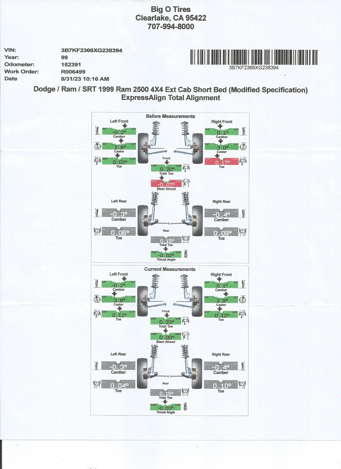

Alignment printout. Hope this works. Not a real computer savvy guy.
Horrible setting... this is for a sports car..
You have even more toe now then before - instead of less.
And this is not the Thuren spec that I said you should have it dialed in, this is the factory setting.
No wonder it wanders all over the road.
0.02° Total Toe or less is what you want to see - not 0.25°
Thanks for your input Ozymandias. While I was a mechanic for many years, I never got involved in alignment stuff. Are you saying I need to take it back to Big O and have them set it to Thuren specs? Will they have access to those specs? Will they balk at this request in your opinion?
Thuren Spec is what you need. If you asked for it to be set to that, I wouldn't have accepted what they set it to, let alone pay for something that you didn't get. With the Thuren Spec, you'll think you're in a new truck!
Print these Data and hand it to the shop.

You have a T-steering from factory, that was the case between 1998 ans 2000.
Your Truck will handle like day and night compared to now.
Insist in using these specs, if they rule to do it look somewhere else.
You pay, you decide - not the Shop.
