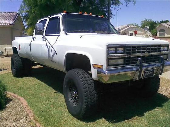

sorry, but i can't help myself. i think this is just sexy.
You posted this on CF and I told you that you could not do it with a SRW rear end. I had 35 12. 50's on my first gen without a spacer between the wheel and drum, I am running a C&C dana 80. It is just wide enough to allow the tires not to hit the leafs. It was super close though. You would have to run a ridiculous spacer on yours to make it work. If you want to deal with the hassle of making the spacer(or buying one) go ahead but you should just find a C&C rear end. You'd probably have the same amount of money in one of those that you would in buying the crap to get your 37's to fit your SRW 80.

I'm not posting this thing up to show it off, I want to give you an idea of how far your tires are going to stick out and what it may look like. I am running a 2. 5in. spacer between the tires, I probably could have went with a 2 or maybe even 1. 5in. and made it work but I had a 2. 5 at the shop at the time.
