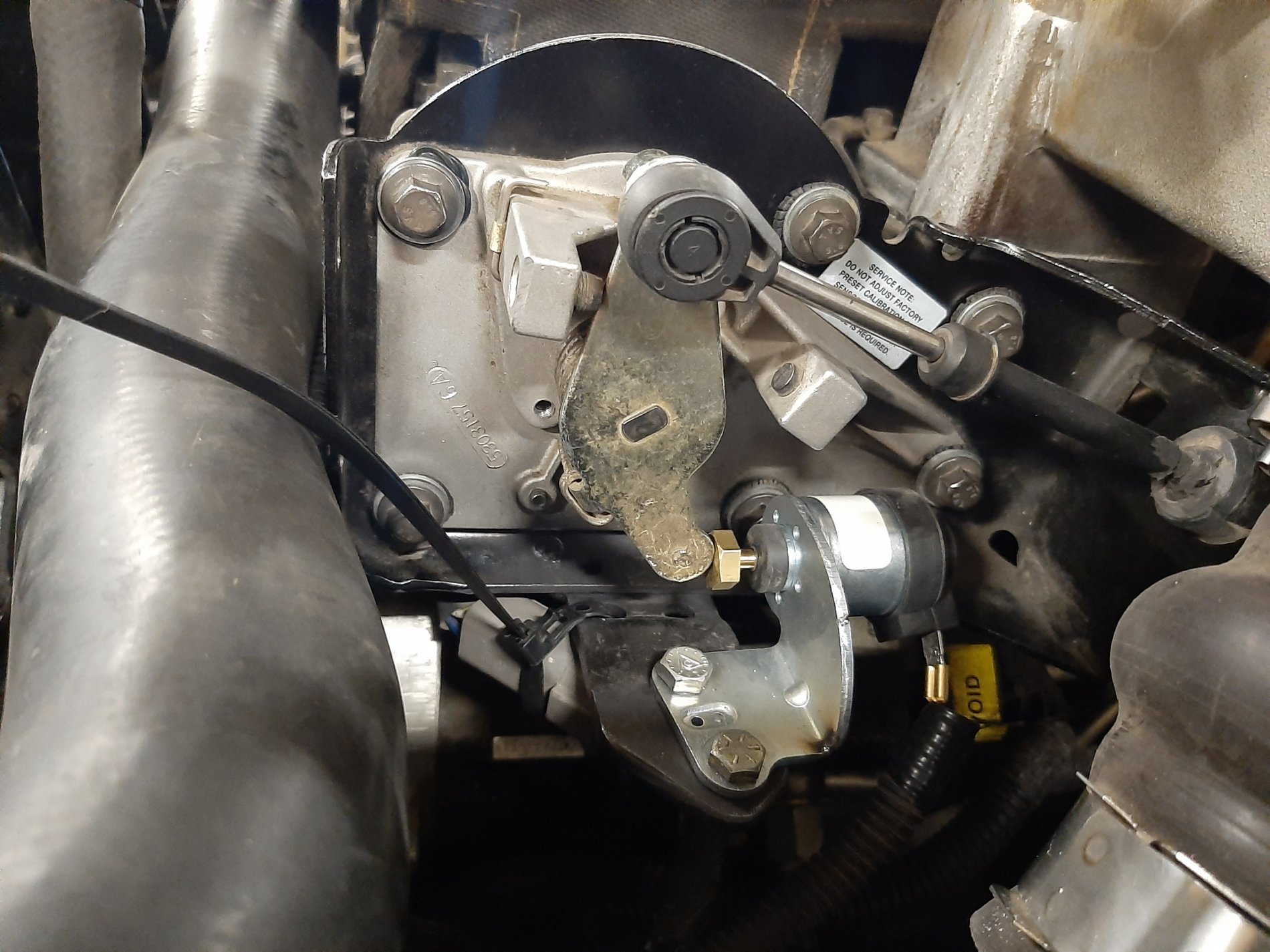

Looking for an old Practical Solutions high idler or info on the circuitry to make my own. Any info is greatly appreciated.

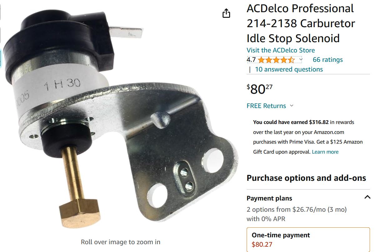

I purchased a fast idle solenoid used on Chevrolets back in the 70's and 80's. The part number is ACDelco 214-2138. I modified the throttle bracket to accept mounting of the solenoid.
The push rod is adjustable. I set the idle a 1100 rpm. It has worked well for over a year now.
