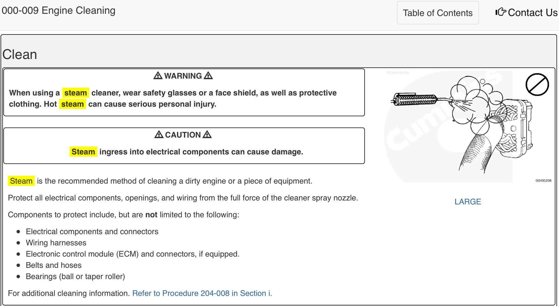

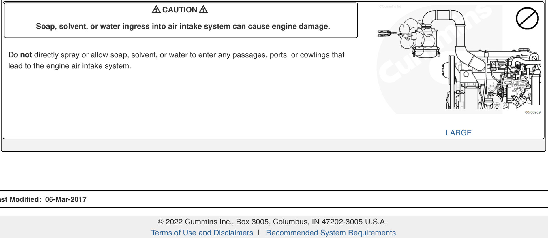

Definitely not a Ram, but this is what the ‘22 Cummins manual says about cleaning the engine.
