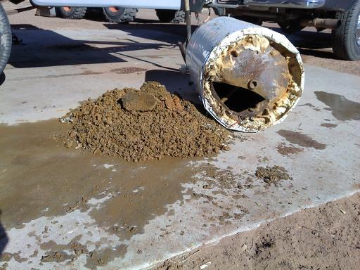

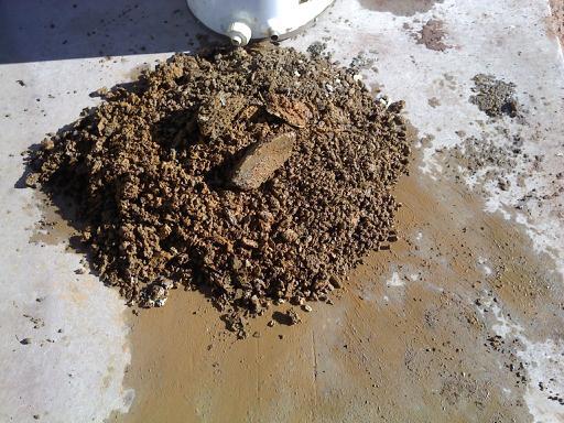

Here is a couple of pictures of the sediment that was in my hot water heater, about 8-10 inches in the tank and above the heating element by about 6-8 inches. I changed the thermostat because the water was too hot on the lowest setting, the new one wouldn't control the heat either so I figured the sediment was insulating the tank at the thermostat and installed a new heater. My guess is the electric bill will go down. I am the curious type so I had to cut a hole in the tank and look:-laf
