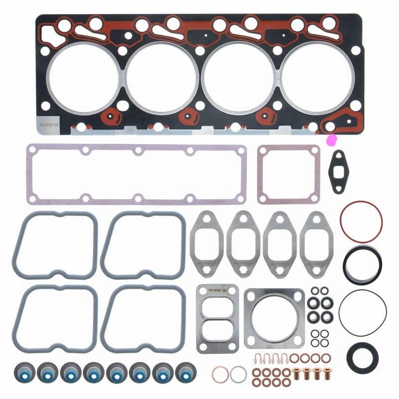

That area is prone to leak on our trucks. You will need to change the gasket. Note the pink dots in the picture. See how narrow the teflon bead is at the thermostat bypass port? The picture is of a 4 cylinder but 6 is the same.
