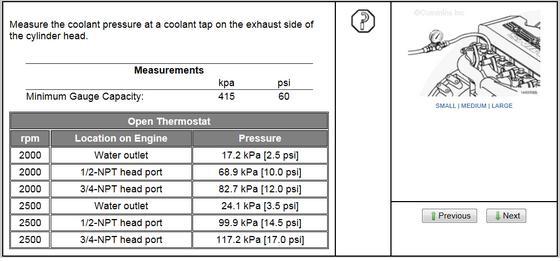

Also, you may want to watch "upgrading" to a higher flow. A standard water pump will blow the freeze plug out of the back of the head if you run high RPM's. I've known people to clip the blades on a stock pump trying to cut down on the coolant flow for this reason. Most folks now running high RPM's run an electric water pump.
Thanks for the opinions. I have used both OEM and Gates water pumps. The Cardone looks to be better quality but I have no experience with other Cardone parts. I have found however that you get what you pay for and the Cardone pump costs twice what a Gates pump costs. Incidentally I have also used Gates fan belts and found that they squeal all the time, no doubt because they cost less. If you can find a seven blade cast iron impeller pump use it no matter what brand.
As to the freeze plug issue, since the freeze plugs are the same on the 6. 7 and the 5. 9 block I would doubt that a water pump change would blow a freeze plug. In any case a water pump has such loose tolerances between the impeller and the block machined surface that the static pressure is inadequate to cause a freeze plug to blow even if the thermostat had no bleeder pin hole and was stuck closed. I would be more concerned about deteriorated components like the heater core or radiator. Remember, the maximum coolant system pressure is relieved by the radiator cap at about 15 psi.
Water pump/block pressure is not included in this figure. I would think that the larger the radiator the more flow you could stand. Too much flow in a small radiator might not allow the water to have time to cool. I did a check on O'Reilly's and they only show one water pump for all years. It appears to have 7 vanes with the ring connecting them.

I was doing other research and remembered this thread talking about blowing freeze plugs out from to much pressure with an upgraded pump. While it is for my 2004. 5 engine I dont think it would be much different.
The freeze plugs blow out of the back of the head form excess heat around that cylinder flashing the coolant to steam, not from the water pump flow. #6 cylinder has restrictions to coolant that cause excessive heat retention under high power applications. They aren't blowing with stock power, mostly with hard throttle and ramped up fuel delivery.
