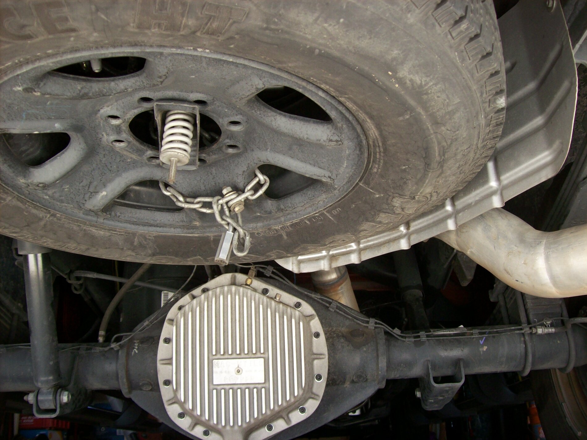

I just have a chain with a bolt through the front part of the rim.

I use a chain with bolt and padlock.
