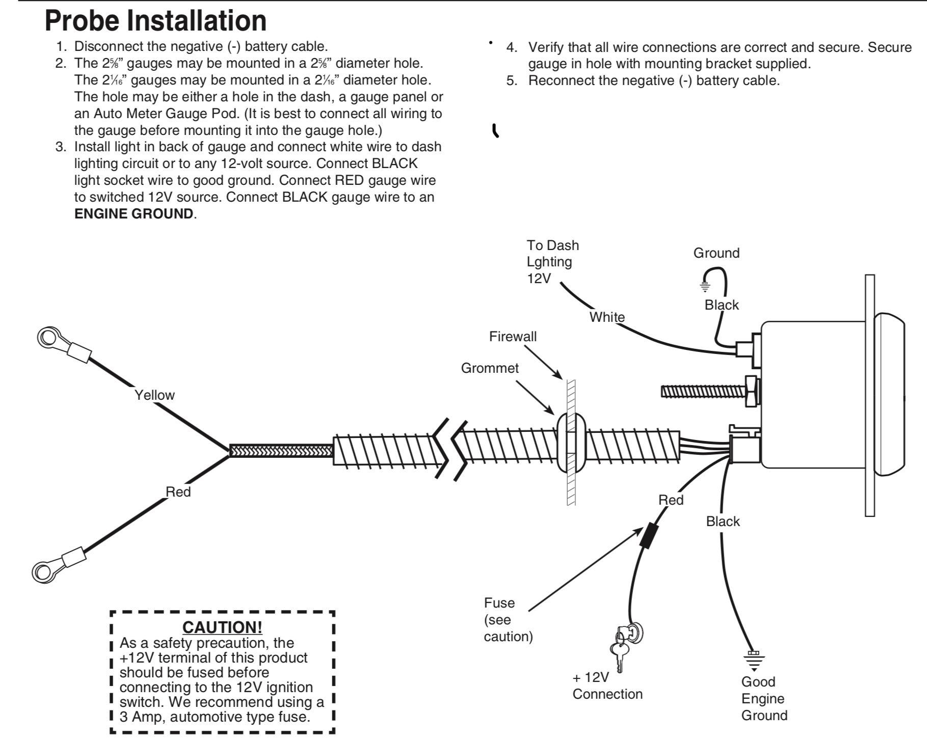

Ive got some weird electrical “issues” going on I thought I’d ask you fellows about. I believe the bulk of the problem is the wiring for my A-pillar gauges that were in the truck when I bought it. The only “problem” is the pyro takes spells where it “wierds out”, the needle flips around rapidly and eventually settles below “0”. I’ve found when this happens, I can turn the headlights on and sometimes I have to turn the dash dimmer all the way down and it will act normally for a while then it starts it again. I found this morning that it also happens when the fan is turned up. Everything but the pyro works normally. As I said, I think this is mostly from some poor wiring on those gauges and I’ll dig into that when I get a chance. Just wondering if others have had a similar problem and what you found. I don’t want it to burn down....
