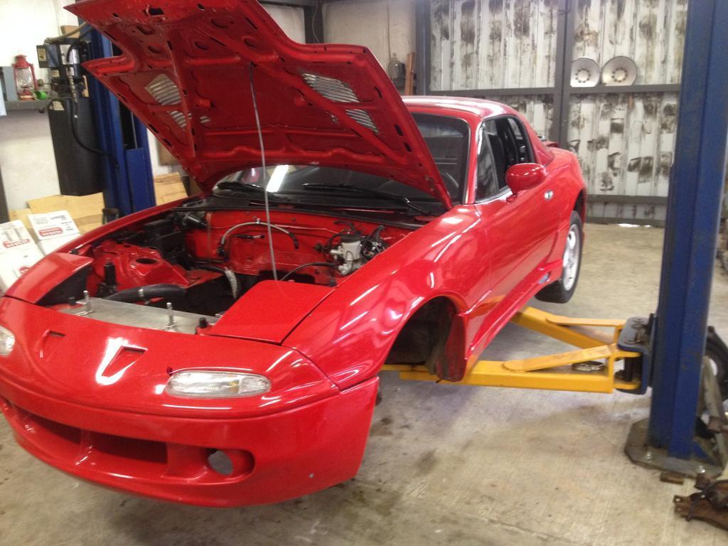

[FONT="]Widen a Mazda Miata na subframe to the max to facilitate installation of new headers on my 302 Ford powered Miata.[/FONT]

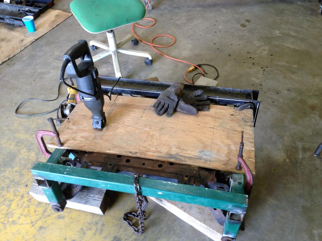

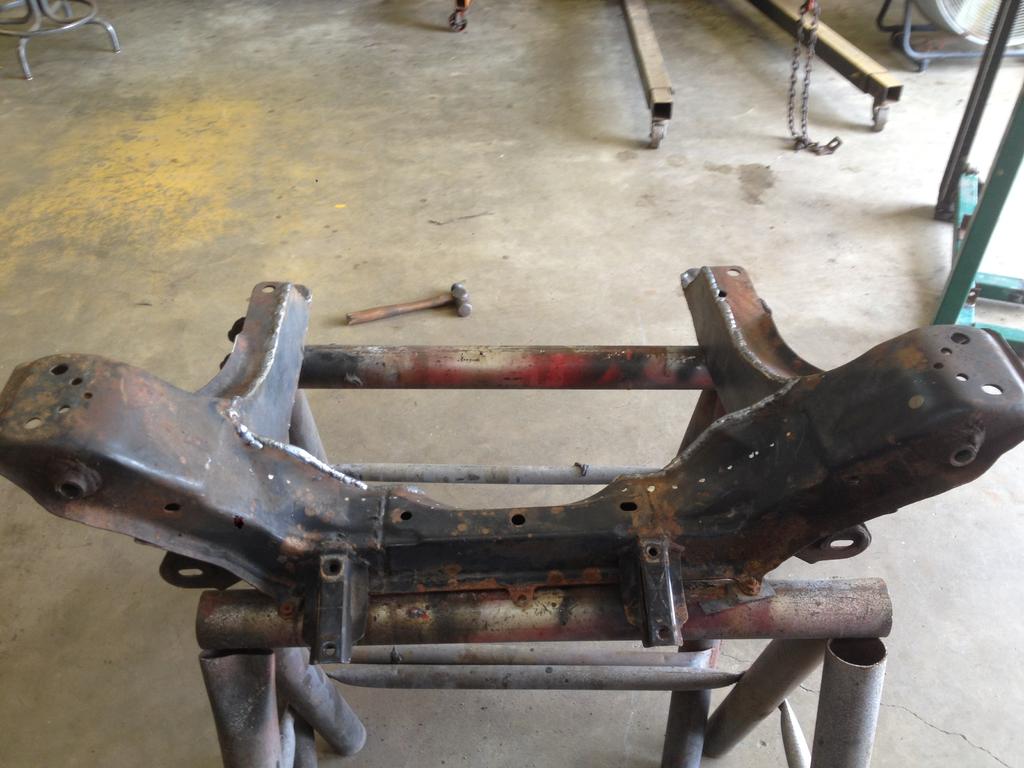

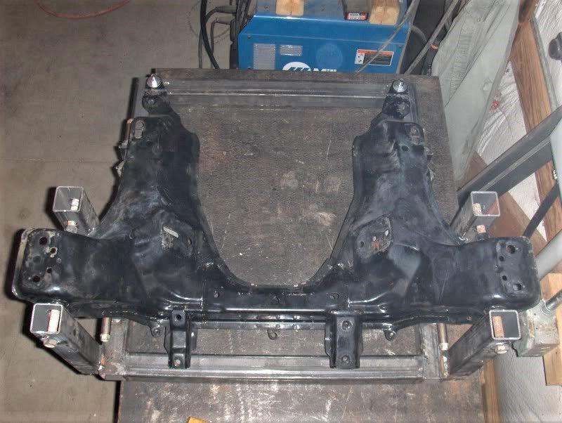

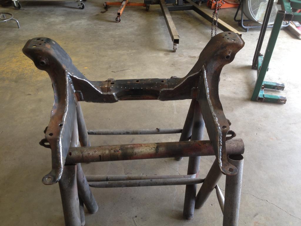

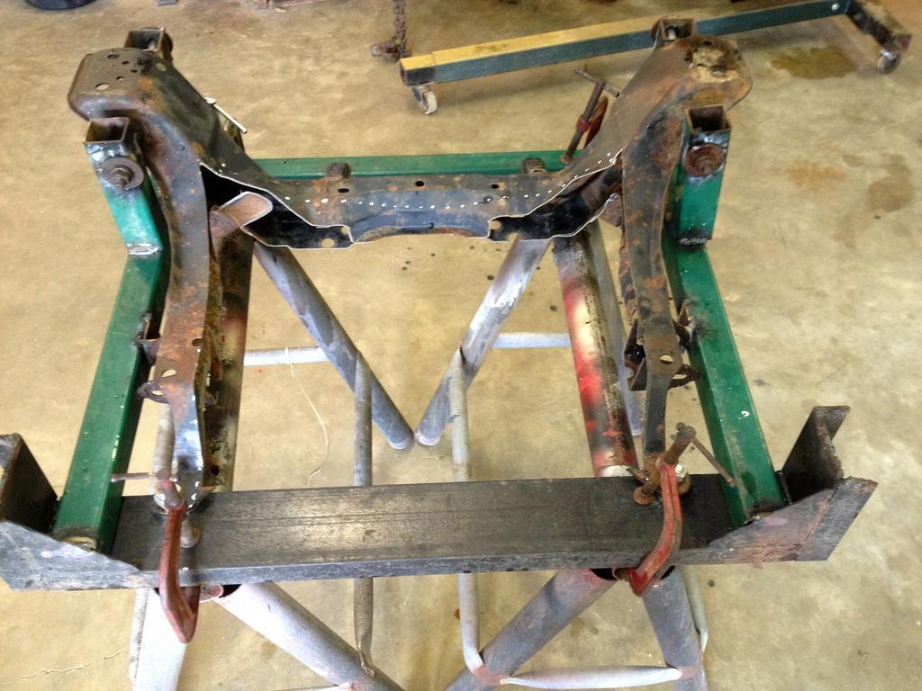

[FONT="]I've built a jig with 1.5" sq tubing with 8 points of contact to hold the subframe in place while it's modified. Bolted a factory front subframe to it and widened the inside clearance to the max....". The rear control arm mounts are basically just hanging on a whisper since I removed substantially all the subframe they were attached to. [/FONT]
[FONT="]My plan for reinforcing or rebuilding the subframe is to use A513 1" X 4" .125 rectangular tubing or possibly 1" X 3" if I can't find 1x4. Reason for the A513 rather than the A36 mild steel I suspect most use in building home brewed V8 Miatas is A513 has a higher carbon and yield strength (72,000psi vs 36,300psi for A36 mild steel). This gives it a greater resistance to bending and it's used in the automotive frame world. [/FONT]
[FONT="]Anyone have comments on the type steel that's best in this application if I'm off in left field?[/FONT]
[FONT="]I'll be welding with a Lincoln 175 amp 220v machine using .035 wire and 75/25 gas. I don't think I need to pre/post heat anything.[/FONT]
[FONT="]My thinking with the rectangular tubing is I'll have a better looking, stronger/safer subframe when compared to what I could fabricate using flat metal only.[/FONT]
