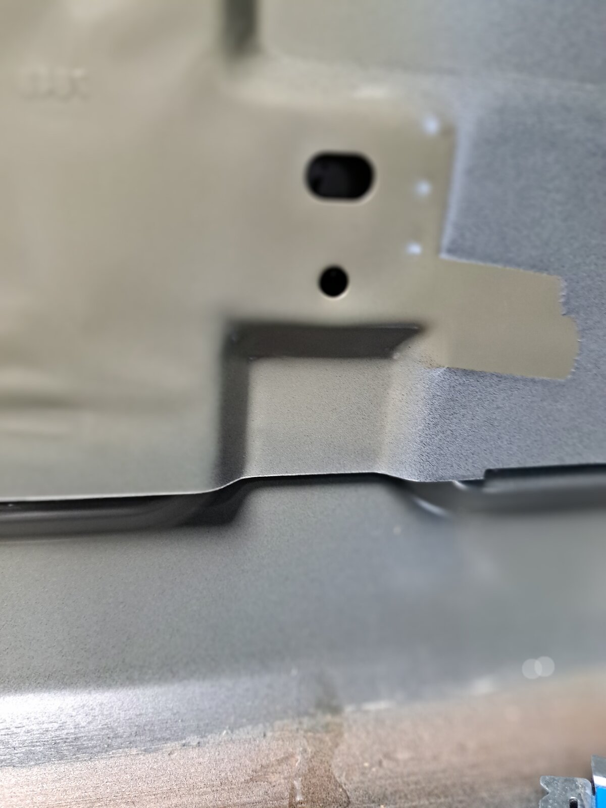

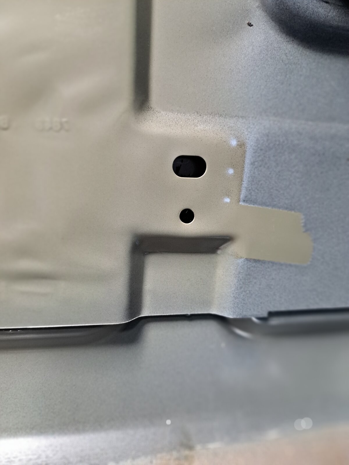

2018 Ram 3500. Smelled musty. Found damp carpet under rear seat. Removed seats and saw that it had the newer Rear Exhauster Vents. I still removed them and cleaned both seals and reinstalled. Then did a water test. The vent didn't leak, but the seam below the vent started dripping water. The pictures aren't the best, but hopefully you can tell where the dripping is. Any thought's.
The 3rd brake light was bone dry, so no problem with it.
