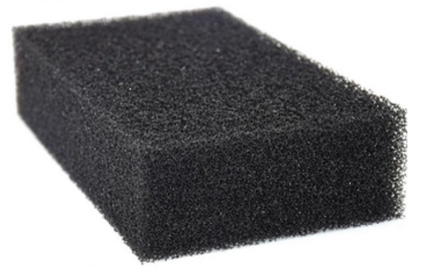

I take some of the foam that’s used in fish tank filters, move the mirror as far one way as it will go and stuff a chunk in behind the mirror, then do the same on the other three sides. It doesn’t take a lot. The foam is very porous so it won’t hold water and it’s soft enough to allow the mirror to still be moved yet firm enough to offer just enough support to stop the vibration.
