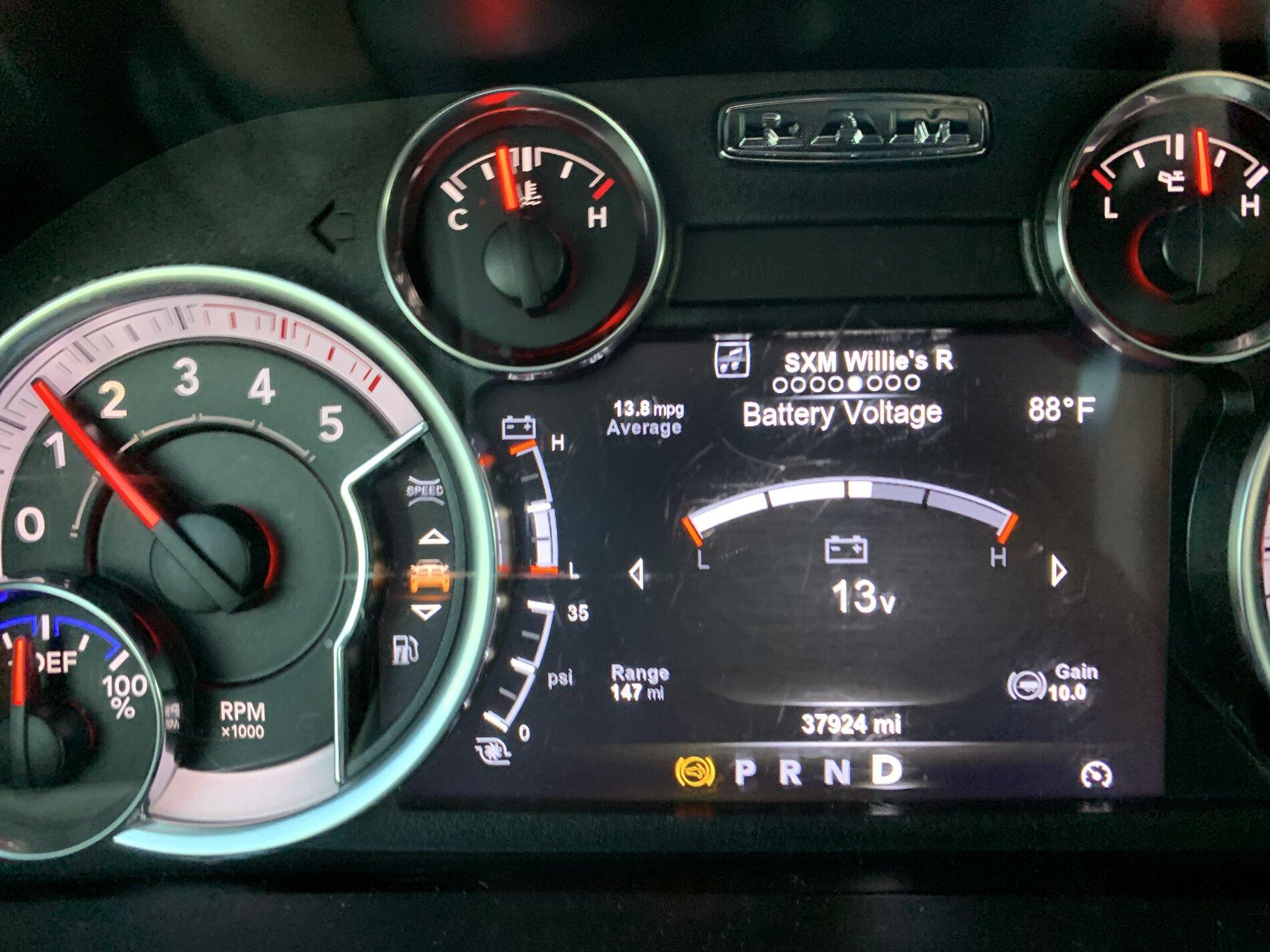

After owning a 98.5 2500 with the 5.9, I have a new-to-me 2018 3500 dually with the 180-amp alternator. No issues at all but one thing I would like to understand better. The displayed charging voltage is always “13”. Not 13.2 or 13.6, etc., just 13. I have owned the truck for 3 months and it has never shown the slightest sign of weak batteries,slow cranking, or any check engine/fault codes. My son-in-law has a 2015 3500 and his display always shows 13 as well. I have worked with Cummins diesels for decades (Case farm equipment) and the voltage standard for (Bosch) charging systems was 14.2 volts. Yes, those alternators had thermal compensation and voltage was lower in summer heat and higher in winter cold.
Not to stray too far from my question but there is a recent Gen 4 TDR alternator topic that discusses the possibility of the alternator going to full charge during regenerative braking. I turned on full Turbo braking mode and made a few deceleration tests while monitoring the displayed voltage. It was rock steady at 13…I don’t think 2018s have regeneration.
So please reply and tell me what charging voltage your Gen4 normally displays

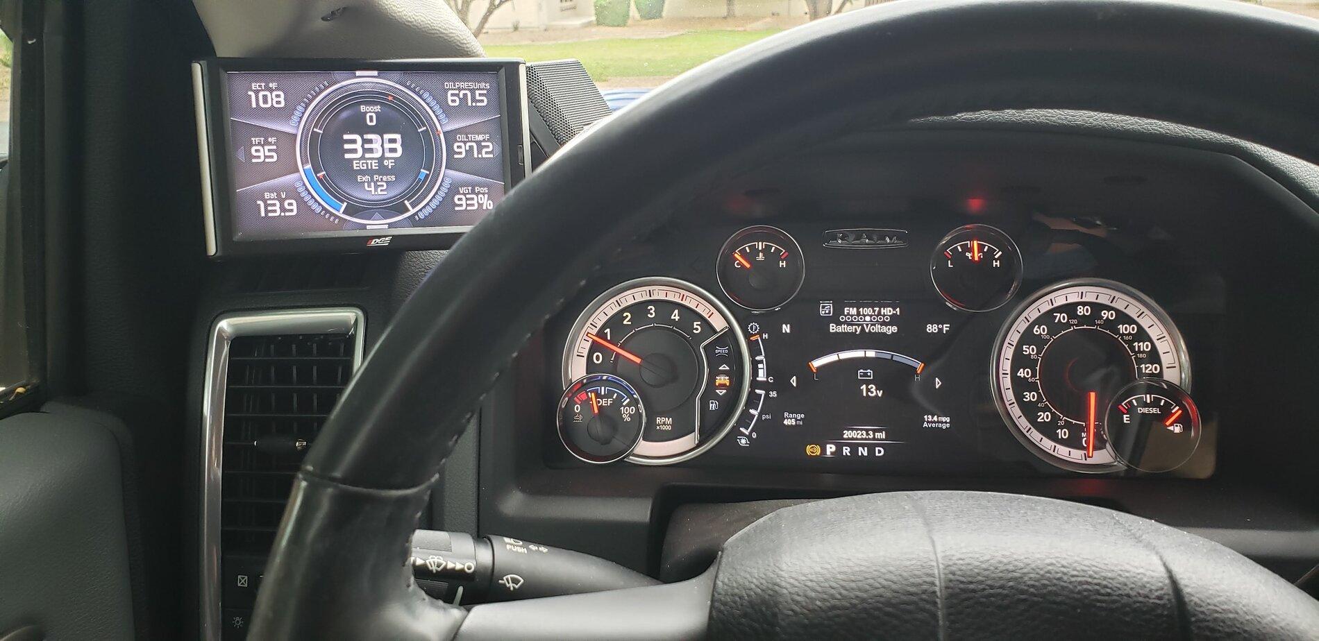

This is the reason that I'm adding a separate digital readout for voltage. I know not really necessary but I'd like to know a bit closer and a bit of a gadget freak! I know on mine it'll say 14v for about the first 10 minutes of driving then drops back to 13v. Like mentioned, it's what the computer is telling the display what to show. Only be concerned when it shows 12v or lower! Enjoy that new ride!!!!!

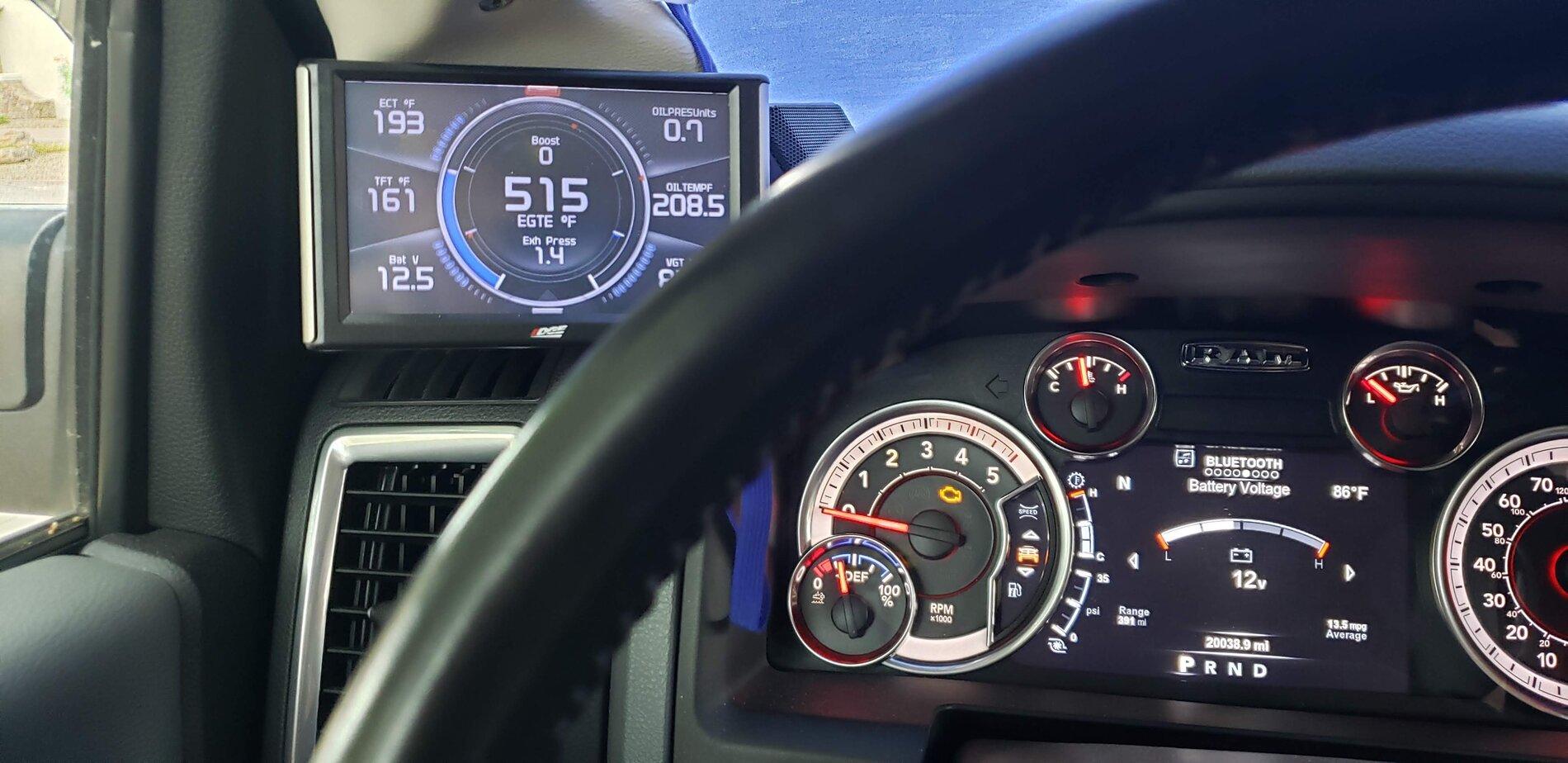

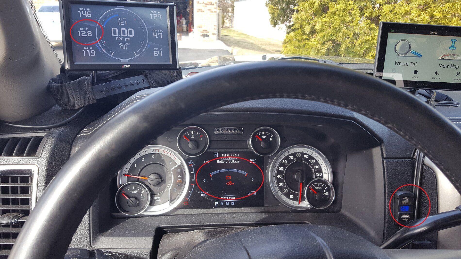

I did some testing on it this morning. The display isn't fake, it is a integer display so really only good to tell you are charging or not. It will display 12V for 12.0-12.9V, 13V for 13.0-13.9 (see attached photos) and probably 14 for 14.0-14.9 but I can't check that until the weather cools. (Battery voltage is bottom left on CTS)
