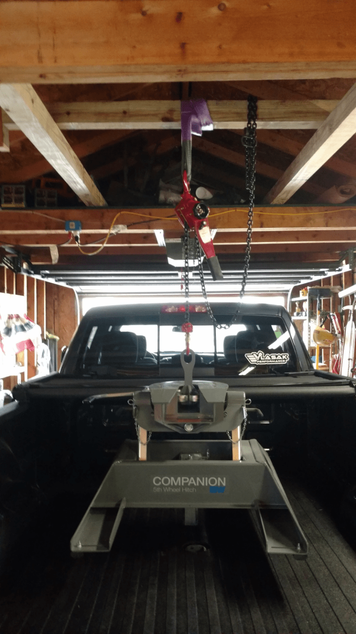

EYTA for pictures..
The hitch is not touching the bed. The balance is perfect. I can slide the 4X4 overhead for alignment.

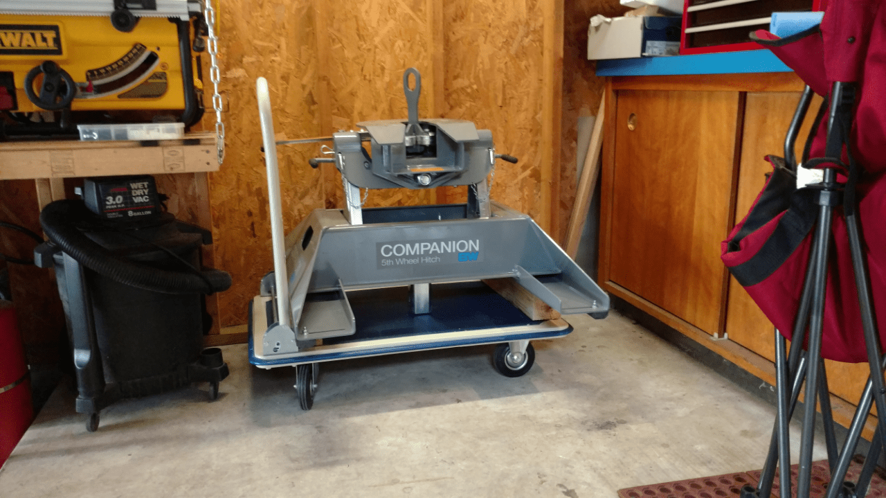

My Companion Slider is 266 lbs. If you can pick that up on your own several times a year without requiring surgery to put the stones back in the pouch your more of a man than I am :D:D
Well I didn’t mention the slider. But I will never own a short bed so I won’t have to see if I can lift it.
