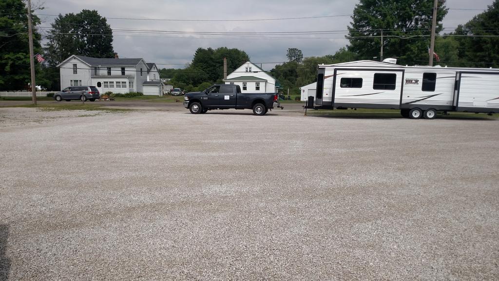

A little off topic but I ended up shooting the breeze with an RV hauler while at the dealer. He was delivering a camper and was waiting to get his papers signed at the counter so we struck up a conversation. He's got a 2016 Ram with 24k miles on it already :eek:. Says it's his first RAM and finally made the jump after his Fords repeatedly left him stranded while out on the road.
Looks like we may have a little competition for gsbrockman:-laf
