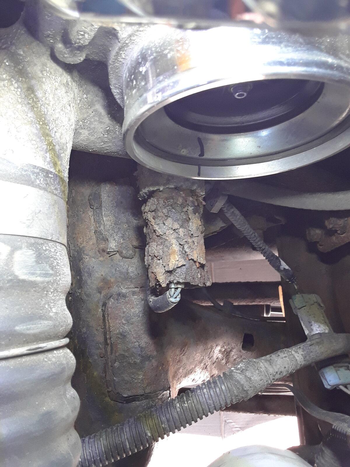

What is this device on the Turbo?
CPP diesel
OEM Fuel Filter Elimination
I was changing my Alternator. To facilitate this endevour I removed the filter box and intake tube. This very rusted device was attached to the compressor side of the Turbo.
Command valve for the wastegate, as indicated by @GCroyle
It's not hard to change. You will get boost related faults, thou I can't recall the exact code.
Given it condition, how difficult will it be to change? When it does fail what code will be thrown?
Not always with a Code, but if you only get around 20psi then it's dead.
You can think of it as an electronically controlled boost elbow, only with it working you see the 32psi boost that you want to see.
