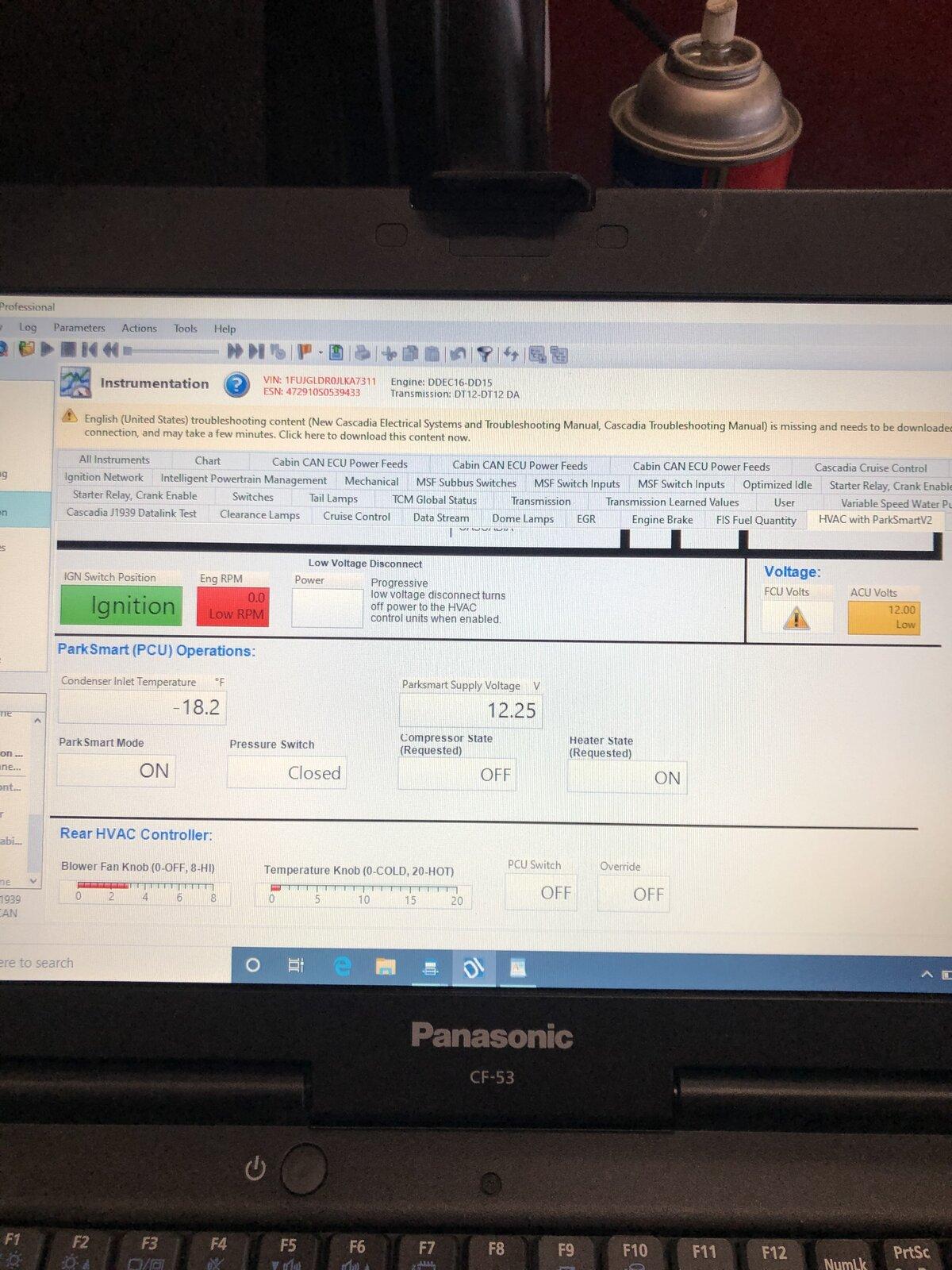

Truck equipped with ParkSmart driver comfort system which provides heat and a/c for the sleeper berth when truck is parked and shutdown...accomplished with the use of an Espar D2 air heater and 4 extra batteries to run a 12v compressor for the closed a/c system...
Complaint is truck refuses to shift over to a/c mode, remains in heat mode no matter what the in cab setting is...truck currently in our shop...
Answer is in this screen shot, if you get it right off quick hold back a little to see if others figure it out....
