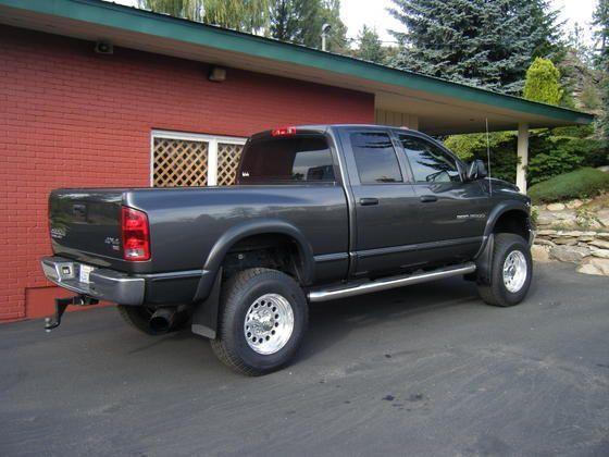

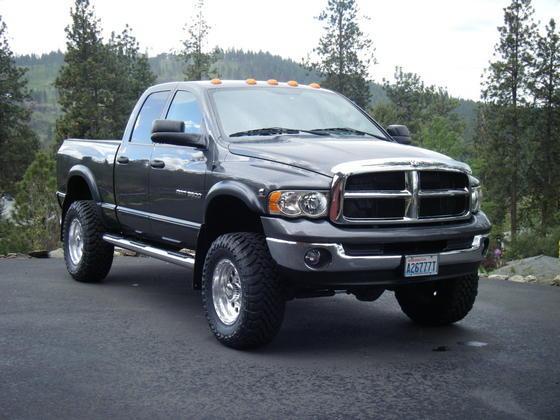

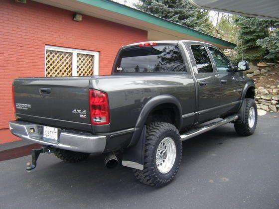

I like the Toyo's ride and for a heavy lug tire they are very quiet, and they look nice, here's a couple pics of both AT/MT's.
Wow. I think that's the worst Toyo report I've ever read here on the forums.
Most guys are usually pretty happy with theirs, with the occasional dude who's comparing apples to oranges and not happy with his oranges, or the 21 year old kid with daddy's Cummins and wondering why his tires won't stand up to his stomping on the gas and slamming on the brakes from stop light to stop light.
Good looking rig.
