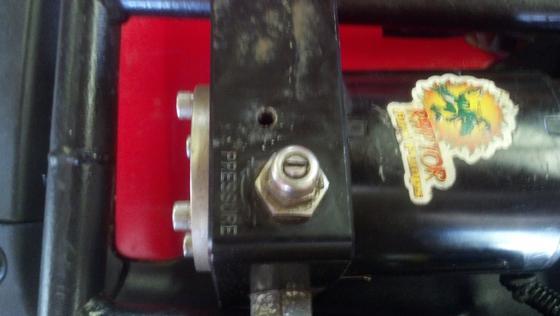

There is no adjustment on the gauge itself. If you have the same pump that I think you do, you should have an adjustment screw on it to increase/decrease pressure. Check to make sure that hasnt come loose. Sorry about the confusion
If you have this style the screw with the jamb nut is the adjustment. If you have the pump with the twin filters I believe the only way to make pressure adjustments is by changing springs. There may be something plugging the inlet or spring that is affecting your pressure.
I heard once that the ball at the end of the spring was plastic and can squeeze up into the spring. The guy used a thin washer between the spring and ball to fix it until he could replace the ball.
