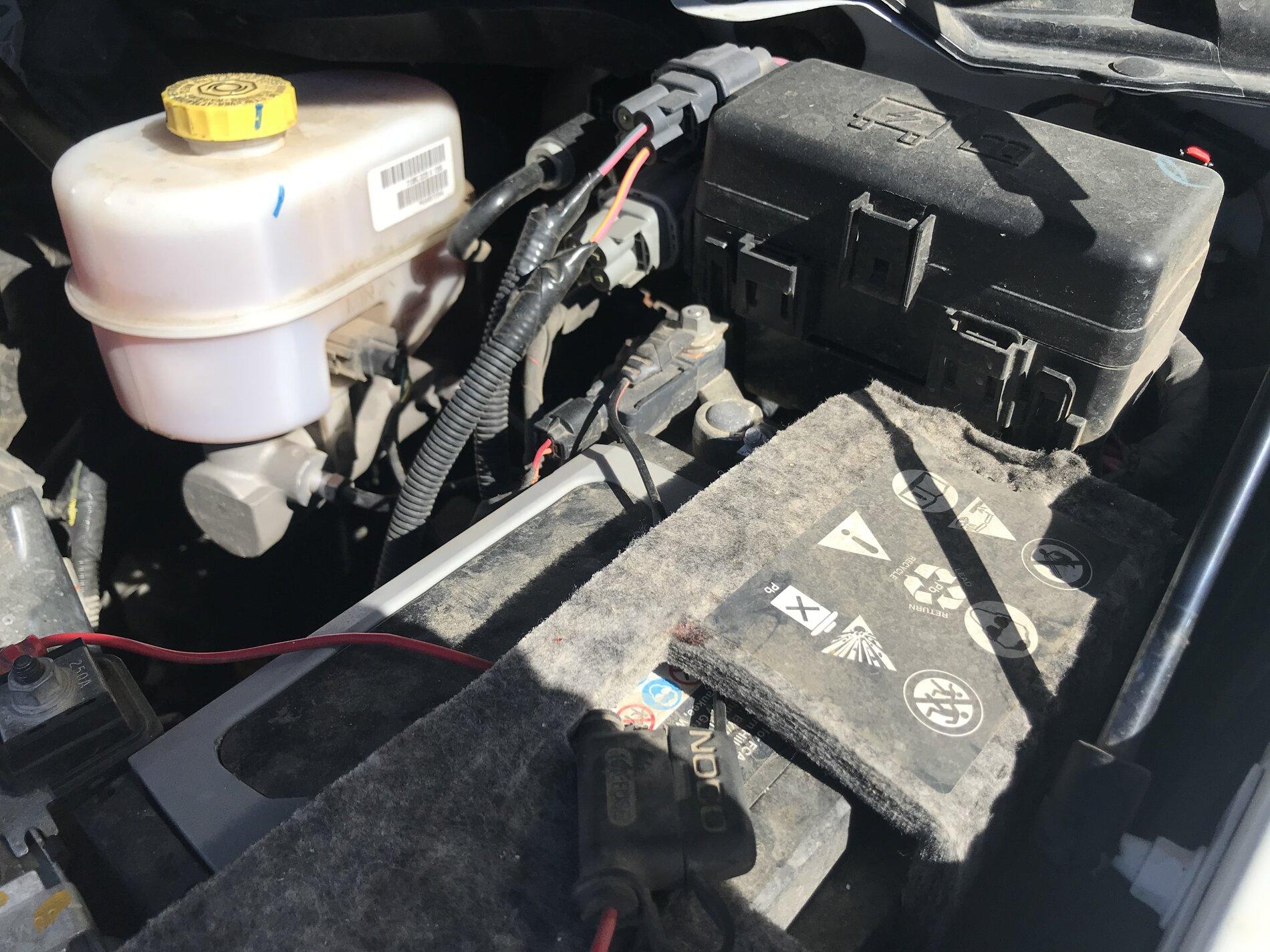

To determine if your vehicle has a smart alternator, look at the negative cable at the battery terminal. If there is a small black box with a small wire coming from it, you have a smart alternator.

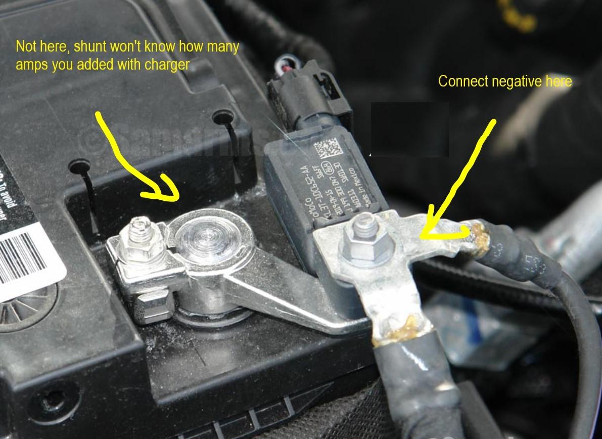

"Smart alternators" do much better with AGM batteries than traditional lead acid batteries. AGMs are OK being partially charged for long periods of time, traditional lead acid batteries are not. Also, it's important to NOT attach the negative lead of the battery charger directly to the battery negative, as the shunt won't sense how much charge was added to the battery, and therefore won't know the charge level of the battery. See picture.
The little black box with the white lettering on it is the shunt. It measures amperage going into and out of the battery, and can help the engine ECM determine the charge state of the battery. With that information, the ECM can decide when to increase the voltage (and therefore the amperage) from the alternator to the battery(s) when it will least reduce fuel mileage. Many cars use this feature to fully load the alternator when the vehicle operator is using the brakes. The load on the engine from the alternator is significant, and will help slow the vehicle, requiring less brake pedal to slow down the vehicle. This is called "Regenerative Braking", I think it was first significantly used in Formula 1 racing. Not sure if Ram is using it yet.
