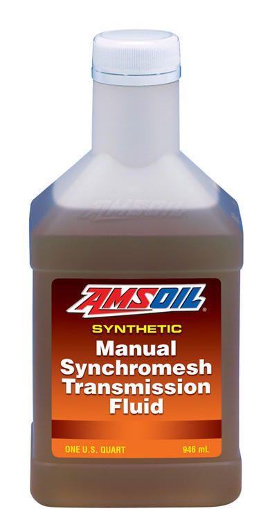

Trans: MTF Syncromesh

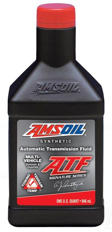

xcase: ATF

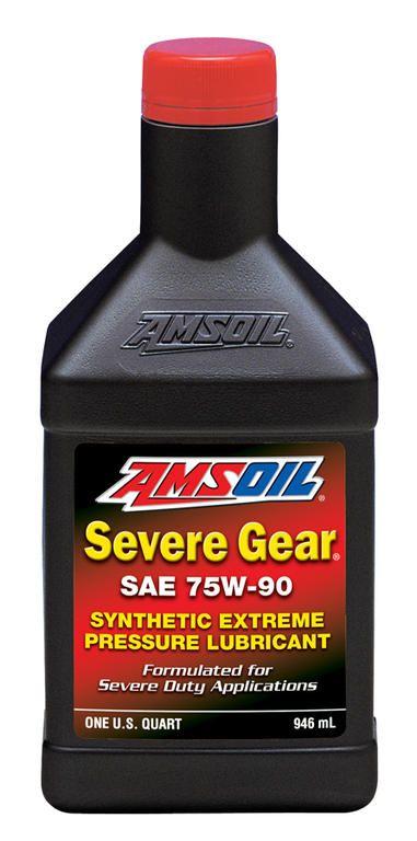

Diffs: SVG 75w-90

here's what I ordered
transmission + one extra quart
axles
transfer case
