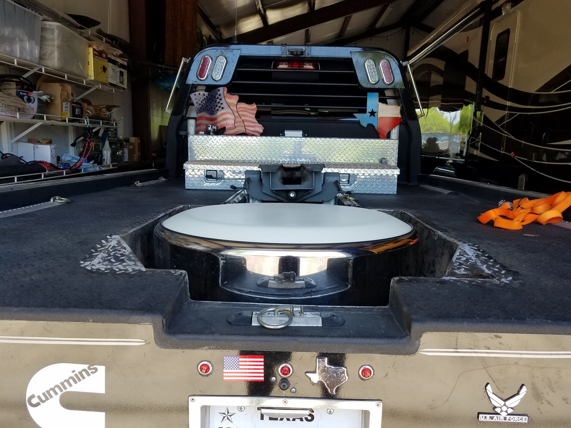

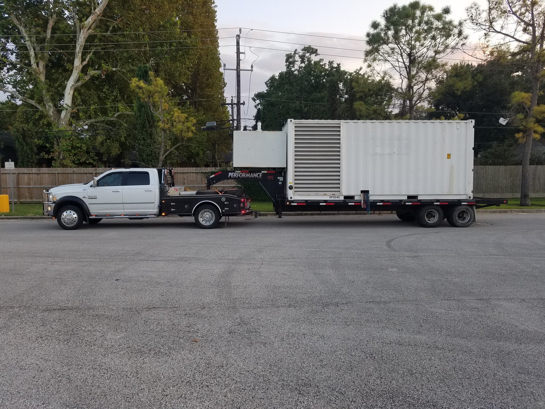

weight capacity is 3klbs more on a 5500. In 2017, Max Tow Pkg included special programing for the Aisin, 4.88s. They didn't up the GCWR # but it could handle way more than advertised. That's 400 gallons of diesel in that 1000 gallon double walled steel tank and a 450KW genset, didntvhave time to weigh it but WAG it around 40K Lbs. Got 35 inc tires on it now.
