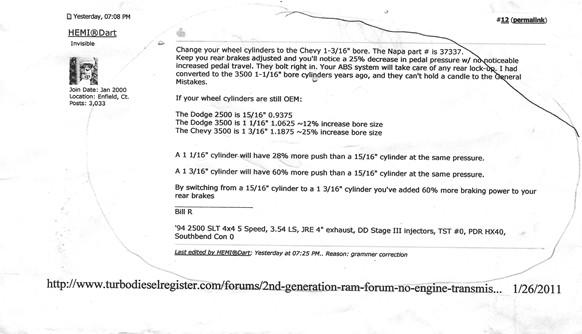

Wheel Cylinder sizes. I ran the GM 3500 1-3/16" bore size for years.
Marked Improvement in braking over OEM 15/16"
Still beat Dodge 3500 1-1/16" by a lot.
No trouble w/ premature rear brake lock-up.
Perhaps a little more during the winter. Anti-Lock option took care of it.
