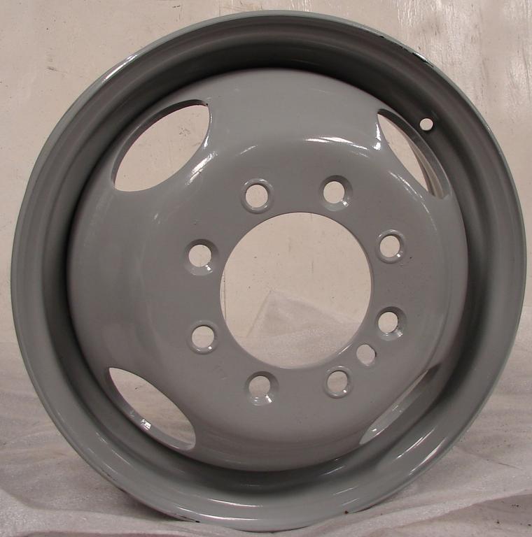

Here is a picture of one, Ford used this style and some older dually Dexter Axles.

Don't those wheels have the alternate concave/convex holes? Without the pin the wheel could line up on two dimpled holes and make it hard to keep tight. * *bg
