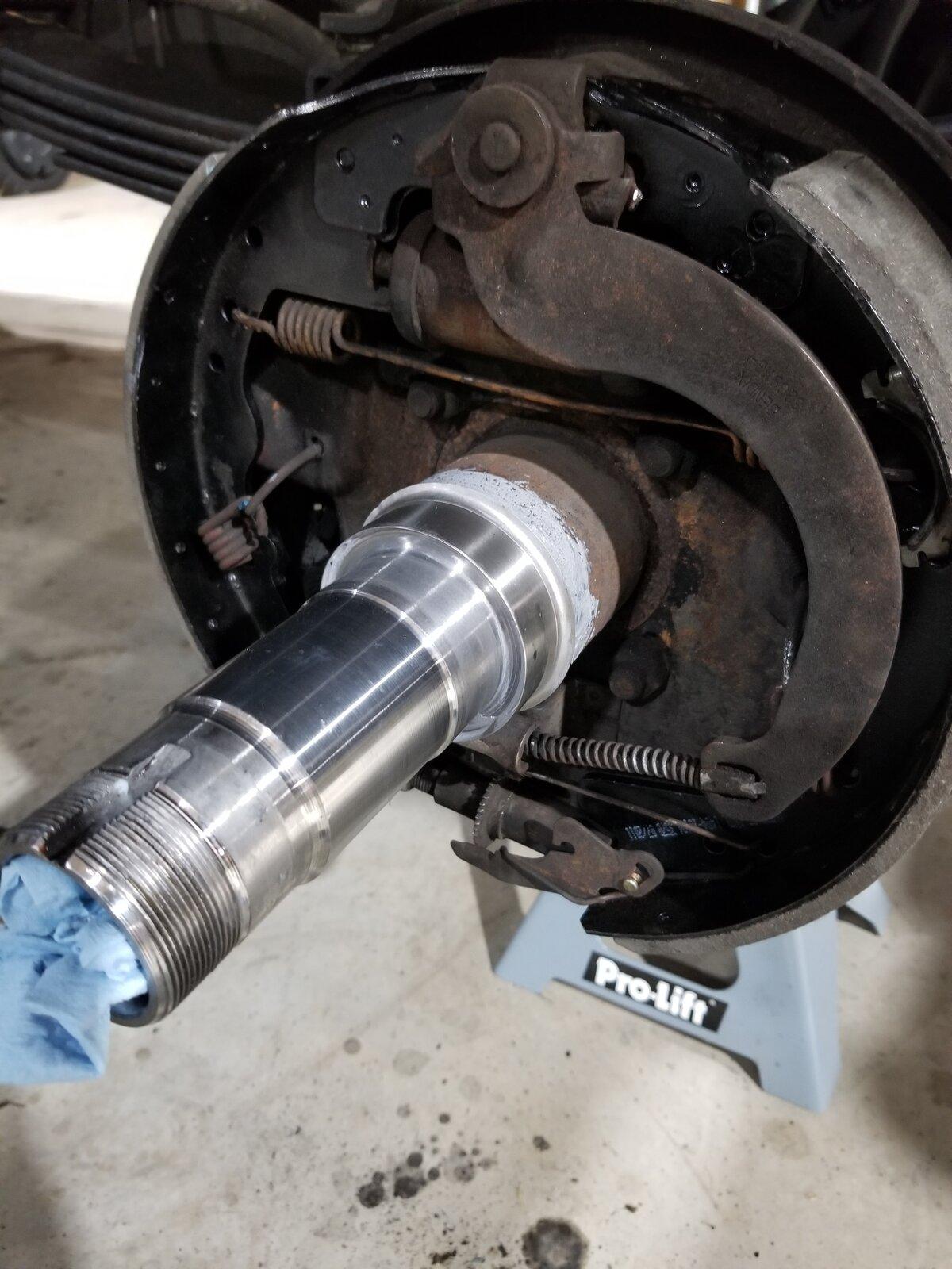

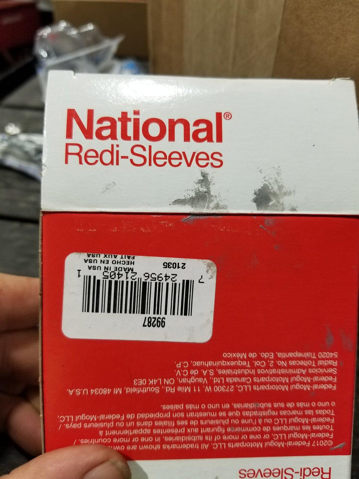

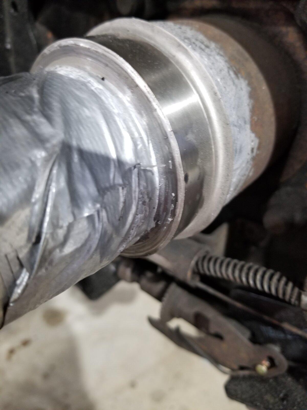

Does the wheel seal fit flush in the hub or does it set in a little deeper ? Working on a 1990 axle out of w350 . Does anyone have a part number for the speedi sleeve for the axle it has a big groove in it
What I used recently on my w250...
