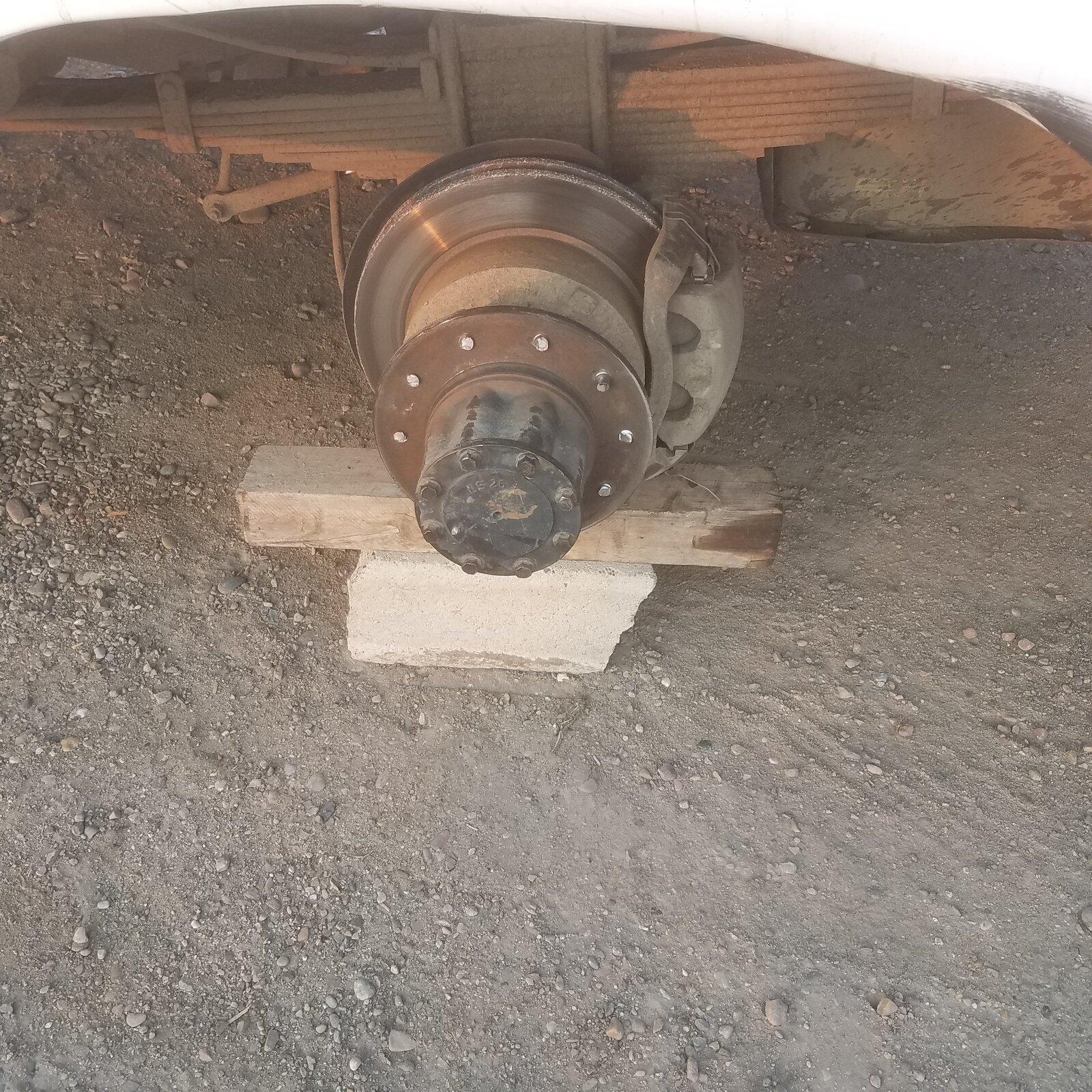

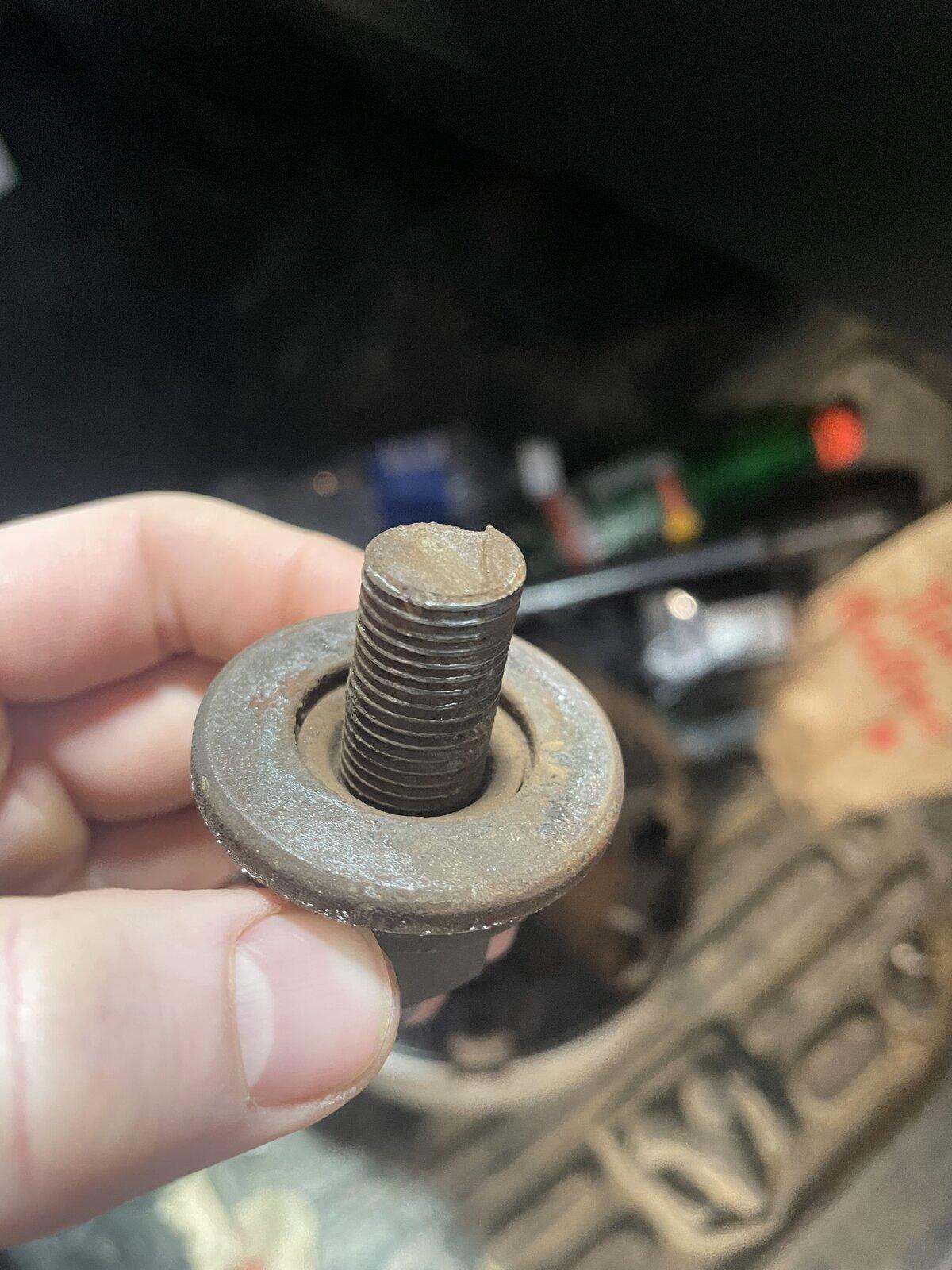

we had these tires fall off a f550 last week. what i believe happened is a tire shop over tightened them beyond the yield point. that allowed some forward/backward lash of the wheel on the axle hub ( i could see where the wheel stud hole was slopping back and forth radially and digging into the stud like a axe). then over time it finally sheared them off. this is one reason nobody touches any part of my vehicles but me

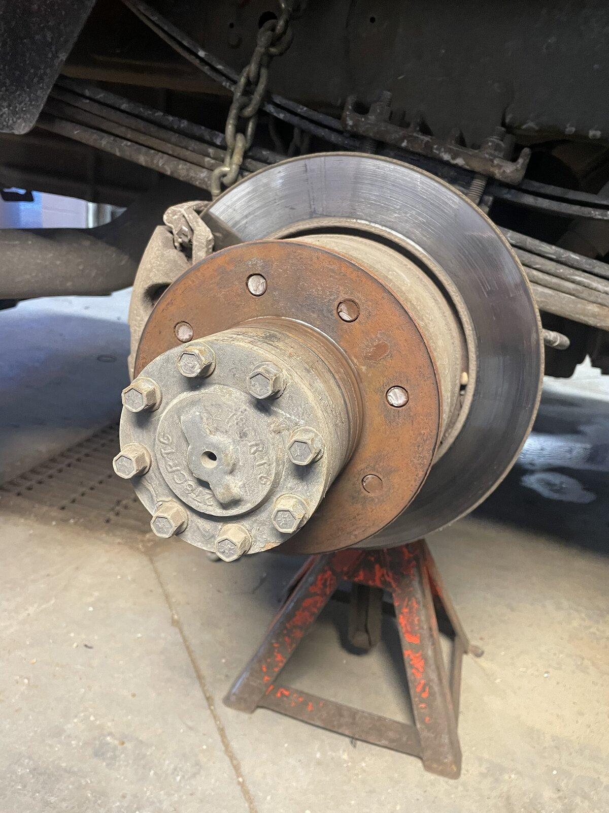

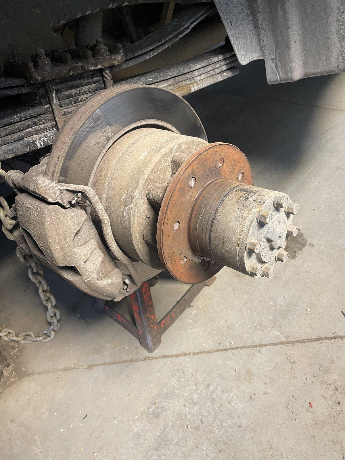

Our 2014 3500 DRW welding truck had all of them shear off. He pulled over into a pull out along the hi way to make a few calls and check emails and when he put it in drive to go the truck barely moved. When he got out everything looked normal. After he called me he tried again and then the hubcap fell off revealing the cause. The truck operated totally normal leading up to this, no vibrations etc., just pulled over and obviously the last few let loose just at that moment. Thank God this didn't happen at hi way speeds which he was doing when he stopped!!

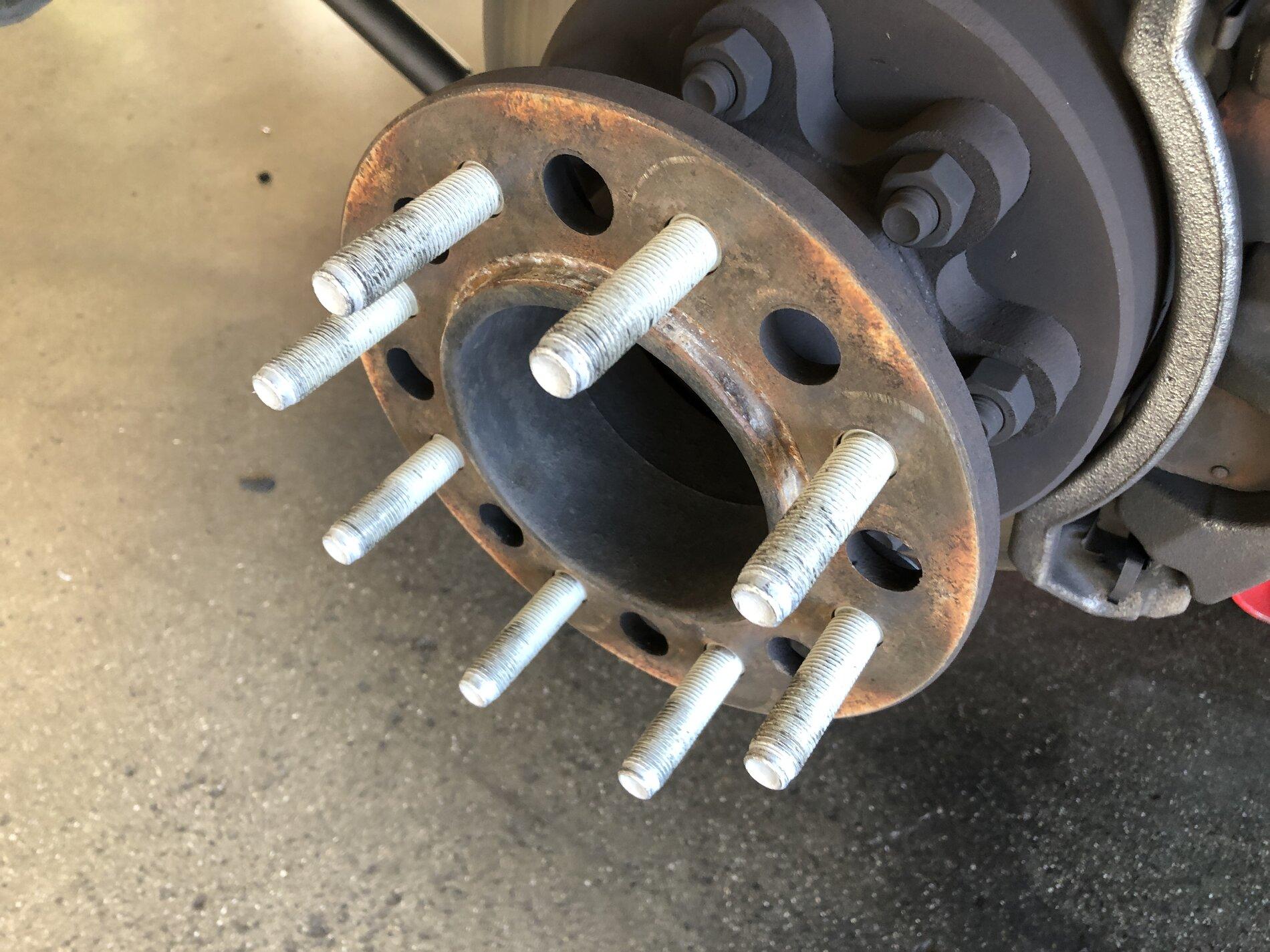

And of course studs are on a national back order. They got this one fixed, but we have three more DRW welding trucks and two personal DRW trucks yet to do and be checked.
