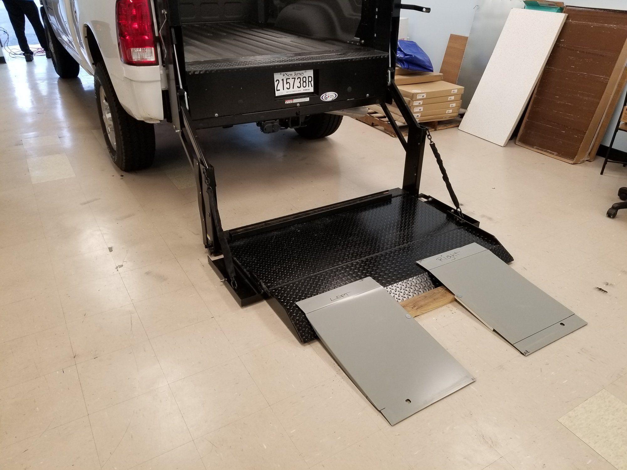

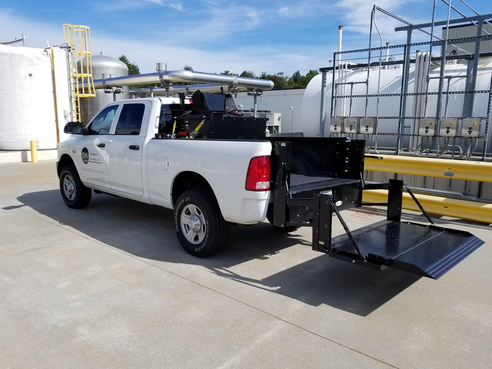

On my one 2500 we have a Tommy Gate G2, its a 38" platform, 52" between the hinges.
I noticed a theme that they tend to pick vehicles with rear lift tail gates, the Kia Sol, Dodge Minivan, maybe going in from the back and adapting a cool set of rear doors that hinge up is a better option here jn place of the fancy slide out.
All in for that gate and back rack was around $3500 installed, its a 1500lb with the added extenstion, you wont need that much. It also maintains the rear back up camera.

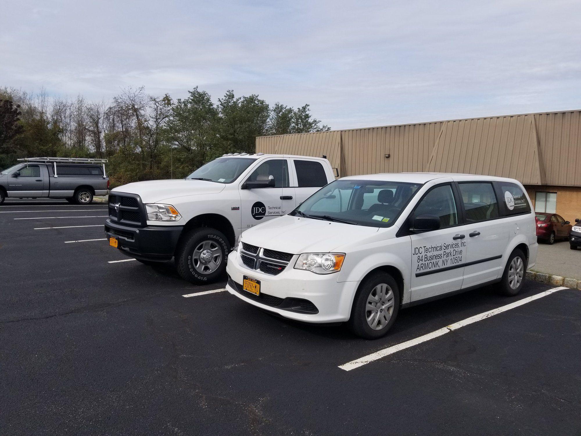

So I happen to have just that set up kinda sitting next to each other today at my shop.
Rough number for sure with out an air ride drop suspension of course.
The 2016 Caravan AVP sits about 15.5" to the drivers floor.
The 2500 4WD (6.4gasser) drivers floor is about 23.5", the floor of the gate/bed is about 39". Quite a difference on my plan to use the back entry.
+/- of course for out of level and the sort.
Gives you an order of magnitude atleast.
