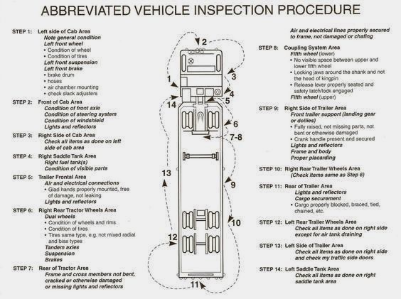

Below is big truck daily. It’s important (IMO) to have something very close for a vehicle new to one that’s got some miles on it. Keep on executing as new wear pattern emerges (new owner).
