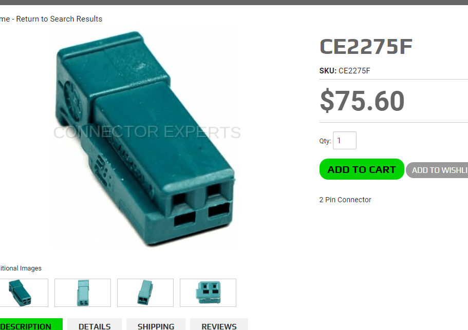

Gotta quote for one..$76 + Shipping... Geezz
Well Be Damned if I am paying $100 for a dinky piece of plastic. Ordered a repair kit for a license plate lamp and will silicone the connection...$15

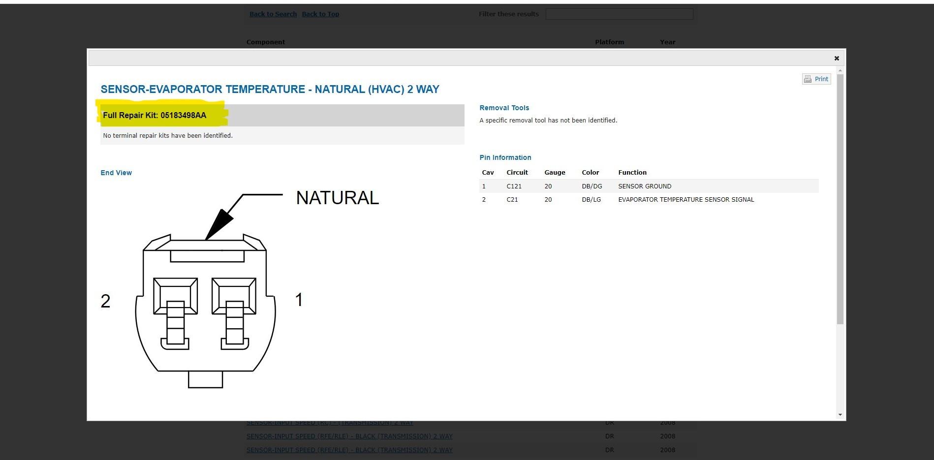

The correct Mopar repair package is only $20. Why butcher it up more when you can repair it correctly for $20?
Sorry I missed your question. Mwilson provided the information. PN is 5183498AA. He also posted the Mopar Connector Site where you can look up all the connectors.
Thanks Guys - Looks completely different from the connecter in place! Will see what it costs to order one in Canada!!! Thanks Again... Unit is gradually coming back together...H
