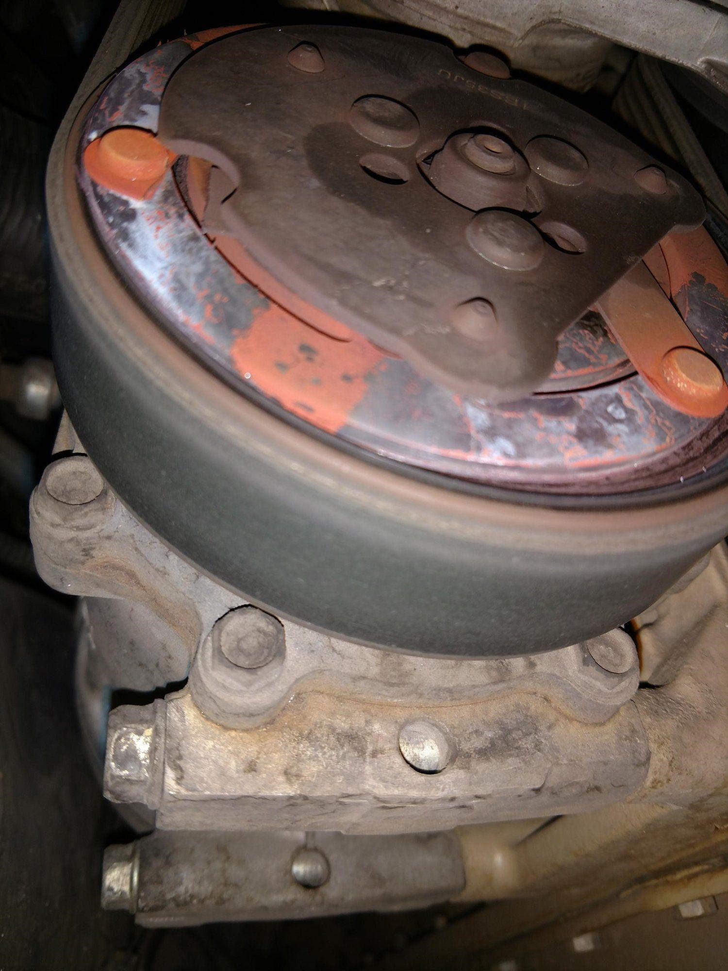

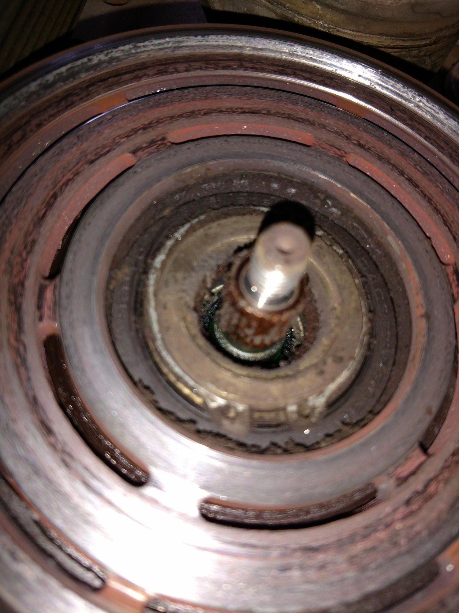

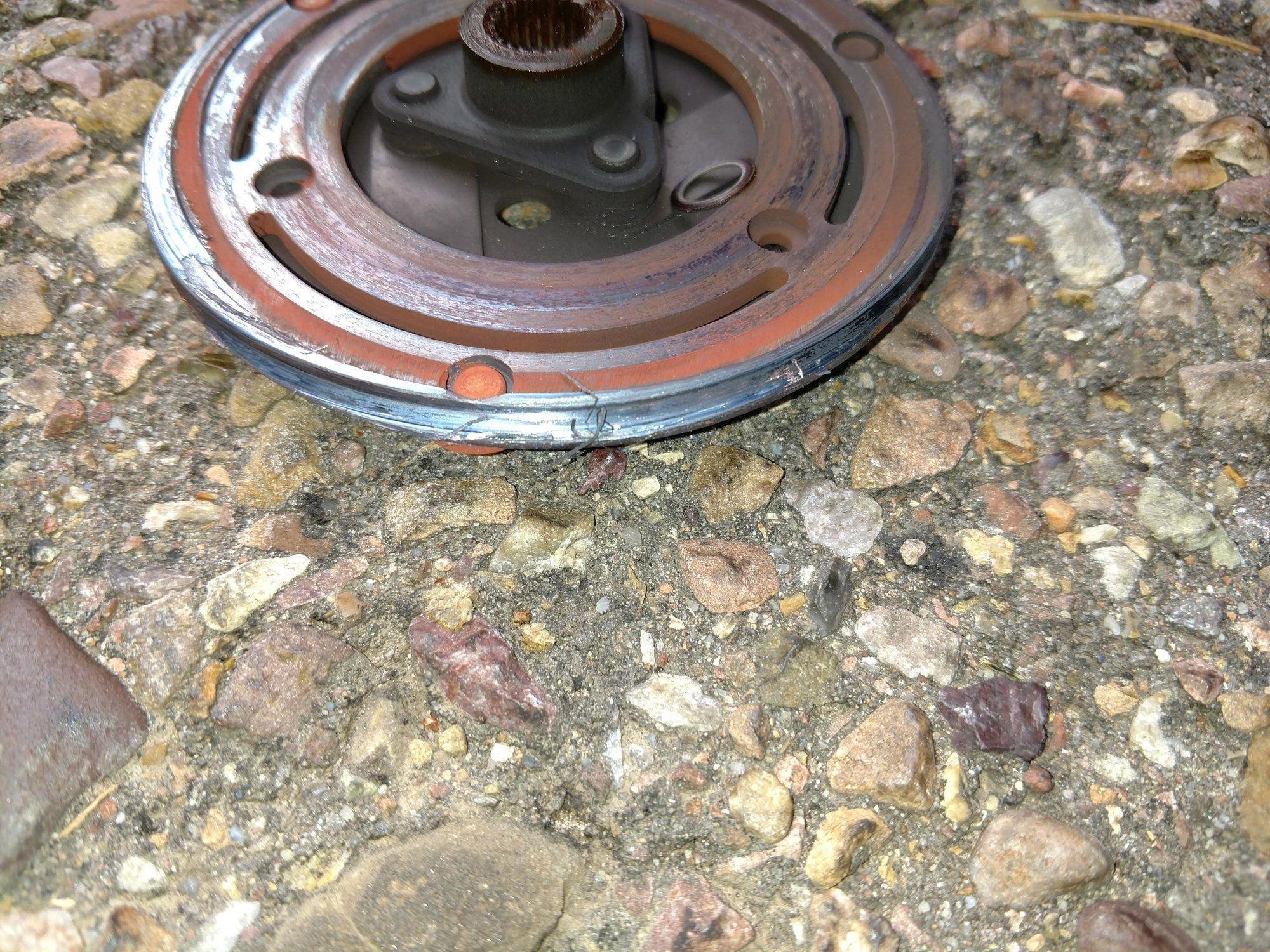

The Green One is at least 1/4 thicker than the standard off the shelf belt and it can survive a AC clutch burn up in high temps. Only reason I replaced mine (nearly 50K on a green one) was exposure to that high temp isn't good for belt life combined with it's age.
Side by side you can feel and see the difference.
