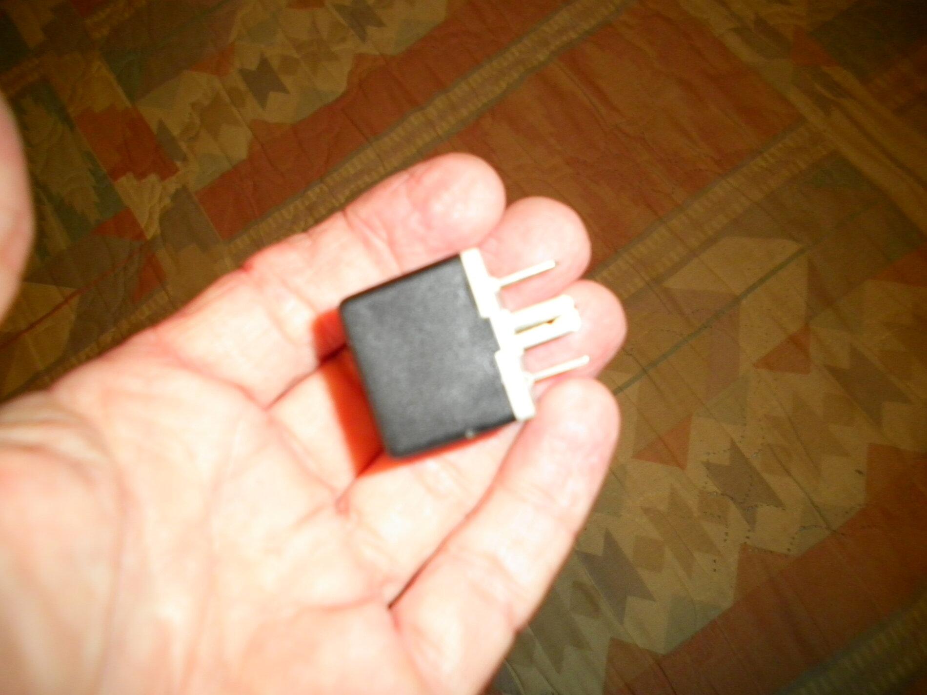

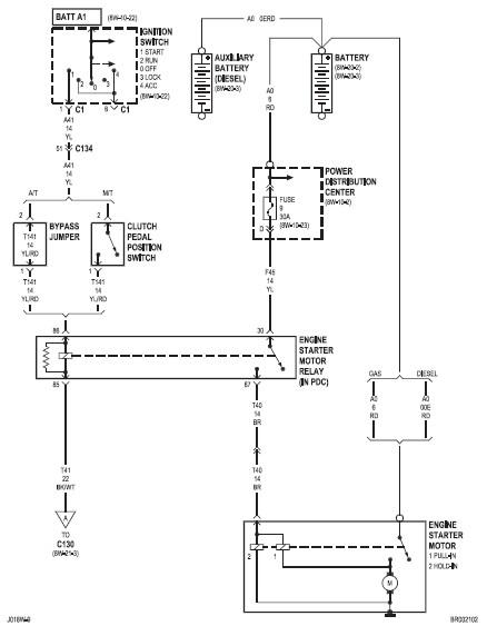

After running test all morning, starting at the battery, I finally got to the starter relay, I wired around it from the fuse box and truck fired right up. so ok that's bad. go to parts store and get one and bingo. fires up. I checked the alternator while it was running and it is bad. not charging at all. I figured the alternator let loose and blew the relay. I haven't replace the alternator yet. didn't buy one. wanted to make sure the relay was the problem. but it will be a piece of cake. it's 150 bucks. gonna wait till all this rain passes through to change it. Thanks for the help guys, i really appreciate it.
