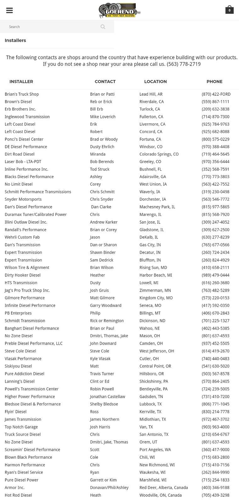

They have a comprehensive nation wide installer list.
https://goerend.com/installers/
