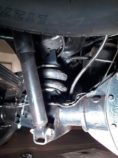

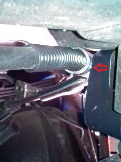

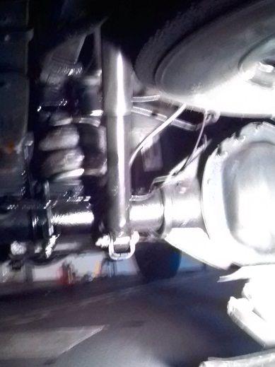

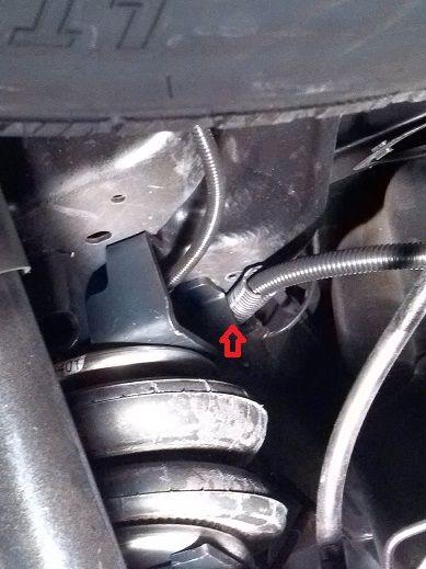

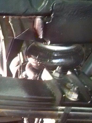

The 3500 has two standard springs, the 6101 on all DRW 2003-18 the DRW has the overload Springs. The SRW has 6102 2013-18, the 6102 leafs are reinforce arch and are 1mm thicker Per leaf than the 6101 spring, thats why the 3500 SRW is 2.33"higher form Ground to tail-gate. the 6102 is much stronger than the 6101. Just add Air Bags to the SRW run 8-12 PSI and you have the GVW of the 6101 and Overloads W/O the harsh banging the 6101+overloads has.
NIsaacs, May be correct to get the 6101+overloads on SRW, I have NOT checked to see if that options now exists. It did NOT when I order My 13&14, it went right to kicking out the SRW and required DRW. It may have changed Now and you can get the 6101+ Overloads on SRW.
The DRW is standard height , the SRW is 2.33" higher, Some of our trailers I needed to make 1.75 Axle brackets to add the additional lift to make the trailers pull true level to PIN/Hitch (GN) It was a PIR to lift all those trailers and add the Brackets.
